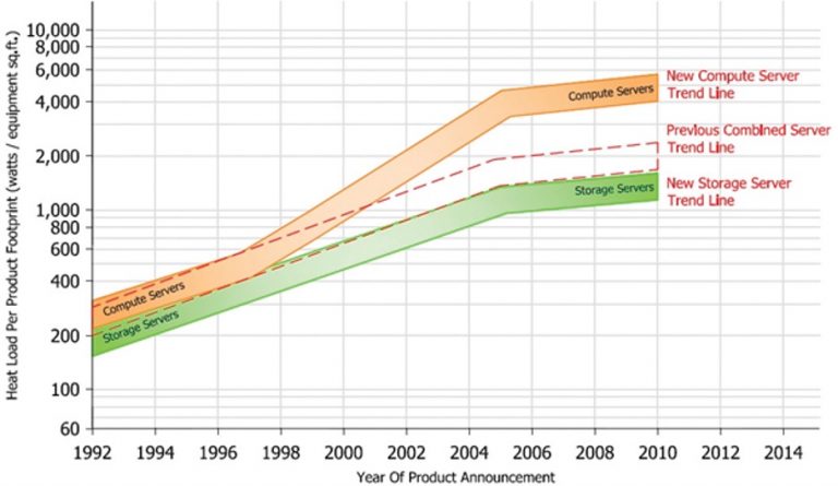

The Economic Meltdown of Moore’s Law
Since the mid-2000s, as computing technology became faster and more powerful, designers and operators were concerned about the efficiency of air-cooling technologies to cope with the increasing energy-draining servers. With power requirements approaching or exceeding 5 kilowatts (kW) per cabinet, some data centers have to resort to technologies such as rear-door heat exchanger and other kinds of in-row cooling to keep the servers cool.
In the Economic Meltdown of Moore’s Law  Ken Brill of the Uptime Institute predicted in 2007 that the heat from fitting more and more transistors onto a chip would result in reaching a point where it would not be feasible to cool the data center without radically revising current cooling technology.
Ashrae-graphs

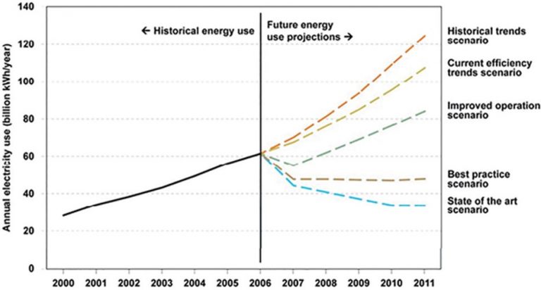

The concern was sufficiently significant for the U.S. Congress to begin investigating. Congress was aware of data centers and the amount of energy they required. It ordered the U.S. Environmental Protection Agency (EPA) to make a study and report on data center energy consumption (Public Law 109-341). This law also ordered the EPA to create efficiency strategies and drive the market for efficiency. This study predicted vastly increasing energy use by data centers unless measures were taken to significantly increase efficiency.
Moore’s Law hasn’t yet happened, but once it does, the result will be limitations in the design of chips and transistors to preventing overheating. This will affect the efficiency of the next generation of data centers.

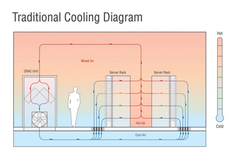

Previously, computer rooms and data centers have employed raised floor systems to deliver cooling air to servers. Cold air from a computer room air conditioner (CRAC) or computer room air handler (CRAH) supplies cool air below the raised floor. Perforated tiles provided a means for the cold air to leave the space between the floors and enter the main space, usually in front of server intakes. Once circulated through the servers, the heated air returned to the CRAC/CRAH to be cooled, mixing with the cold air. The CRAC unit fans ran at a steady speed, and the CRAC had a humidifier within the unit that produced steam. The primary purpose of a raised floor was to deliver cold air where it was needed, with very little effort, by simply changing a solid tile for a perforated tile.
Tradiional Cooling Diagram
That common design system for computer rooms and data centers is still being used today. The legacy system depends on simply delivering a relatively small quantity of conditioned air and letting that small volume of conditioned air mix with the room air in the space to reach the set temperature. This system worked perfectly when ITE densities were low. Low densities allowed the system to meet its primary goal, despite shortcomings of poor efficiency, and uneven cooling.
With that in mind, modern data centers are no longer utilizing raised floor technology, because there are now improved air delivery techniques.

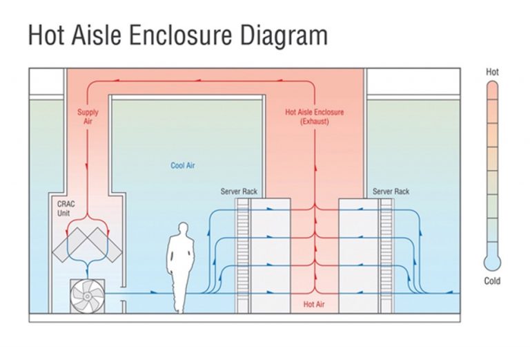

In a controlled Hot Aisle containment environment, the ITE hardware determines how much cool air is required. The cooling system fills the room with temperate air. As air is transferred from the cool side of the room by the server fans, the differential pressure in the room will quickly transfer the air to the warmer side.
In order to make it work, the server room should have a large, open ceiling plenum, with clear returns to the air-cooling equipment. It is more convenient to have a large, open ceiling plenum than a large, open raised floor, because the ceiling plenum does not have the burden of supporting the server cabinets. The air circulators remove warm air from the ceiling return plenum.
Hot Aisle containment systems can deliver a higher volume of conditioned air compared to that of Cold Aisle Containment. In a Cold Aisle containment system, the amount of air in a data center at any given time is the same in the supply plenum and in the contained Cold Aisles. In a Hot Aisle containment system, the room is filled with hot air that is limited to the air inside the Hot Aisle containment and the ceiling return plenum.
Hot Aisle containment gives operators the option to remove the raised floor from the design. Temperate air fills up the room, often from the outside. The containment prevents contamination, so air does not have to flow in front of the ITE. Removing the raised floor reduces initial costs.

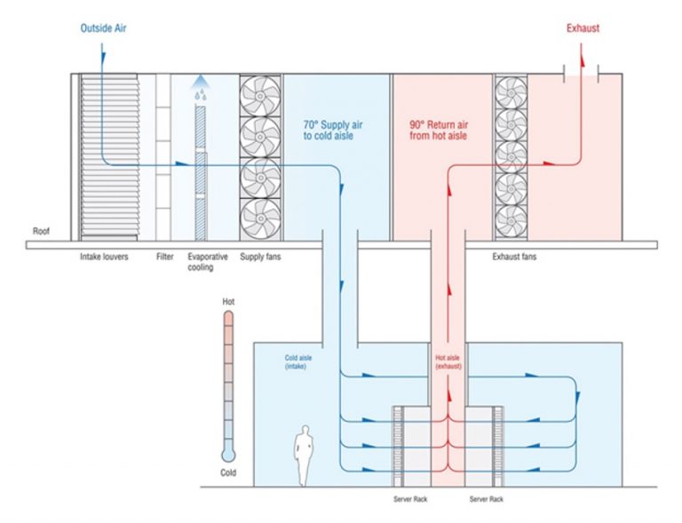

  • Airside economization
  • Airside economization with direct evaporative cooling (DEC)
  • Indirect evaporative cooling (IDEC)
Economizer Cooling
Cooling systems have some form of a refrigerant-based thermodynamic cycle to obtain the prescribed environmental conditions. Economization is cooling in which the cooling cycle is turned off, sometimes partially, or all of the time.
Airside economizers suck outside air into the data center, which is often blended with return air to get the right temperature as it enters the data center. IDEC is an alternative of this where the outside air does not enter the data center, but dissipates the heat from the inside air via a heat exchanger.
Evaporative cooling (either direct or indirect) methods use evaporated water to help the economizer to cool. The water absorbs the energy, setting the dry bulb temperature to a point where it approaches the wet bulb (saturated) temperature of the air.
In waterside economizer systems, the cooling cycle is not needed when outside conditions are cold enough to achieve the desired chilled water temperature. The chilled water passes through a heat exchanger and carries the heat to the condenser water loop.
