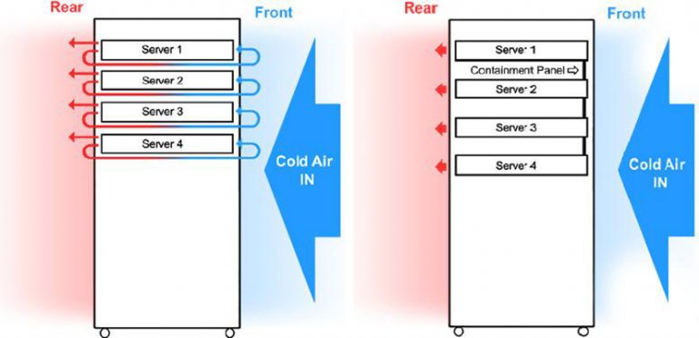

Proper Server Rack Airflow
Server racks help to direct airflow through the cabinet as the equipment mounted inside draws the air through. When the cold air passes over the hot components in the servers it carries with it the heat which is the expelled through a performed screen door at the rear, or sometimes chimneyed through the top of the rack. The rack is designed to ensure an even flow of air to remove heat as efficiently as possible. However, if there are open bays in the rack, it will disrupt this even distribution of airflow. When this occurs insufficient cold air may pass through the servers. Other results of this would be :-
  • Dead Spots – When there is an open U in the rack, airflow will pass through the easiest path, the large openings provide an easier route than through the constricted pathway through a server. This results in dead spots where the air is not moving or moves slowly. These are also known as rack hot spots.
  • Incorrect Airflow Direction – in a containment setup where hot and cold air is segregated into hot and cold aisles, any openings between these aisle can allow the mixing of air. Even without containment, the opening can allow hot air being expelled at the rear of the rack to re-circulate to the front and be sucked back into the server degrading cooling efficiency. Proper pressure differential must be maintained and can be checked with AKCP differential air pressure sensors.
  • Tornado Effect – When air hits an opening it can spiral and blow in the wrong direction. This spinning air disrupts the cooling effects of the airflow.
  • Reduction in Efficiency – Having areas of stagnant air and hotspots in your rack decreases the efficiency from the planned capacity. This results in extra loads being placed on cooling equipment and increased power consumption with the associated energy costs.
