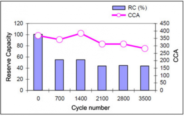

This activity is evident in phones, laptops, and most cars. Cranking the engines several times a day stresses starter batteries. But this is a bit different from the start-stop operation of a micro-hybrid. At red traffic lights, micro-hybrid turns off the internal combustion engine (ICE). When the traffic flows, it turns the ICE on. This results in about 2000 micro-cycles per year. Studies show the battery capacity dropped to 60% after two years of use. The solution is to use specialty AGM and other systems.
Cadex laboratory studies show a drop of 50% when the battery was exposed to 700 microcycles.
battery-cycles
