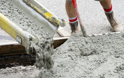

Protect the Concrete from Freezing
Photo Credit: www.thebalancesmb.com
The concrete’s minimum compressive strength is 500 pounds per square inch (psi). It is achieved within the first 24 hours after placement. Until the concrete reaches this state, utmost protection from freezing is important. Water usually freezes at around -3 to -4°C, and at this point, hydration will stop. When water within the concrete freezes, the strength will be compromised, reducing it up to 50%. Inadequate strength cannot withstand the expansive forces of freezing water. Freshly poured concrete can be damaged at dropping temperatures. The frozen water will disrupt the formulation of the cement paste matrix. Cement paste is the combination of all the particles mixed with cement. Examples are sand, gravel, and bitumen to form a concrete mass. The ice can expand at 9% of its volume as it forms, disrupting the freshly poured concrete by the ice crystals.

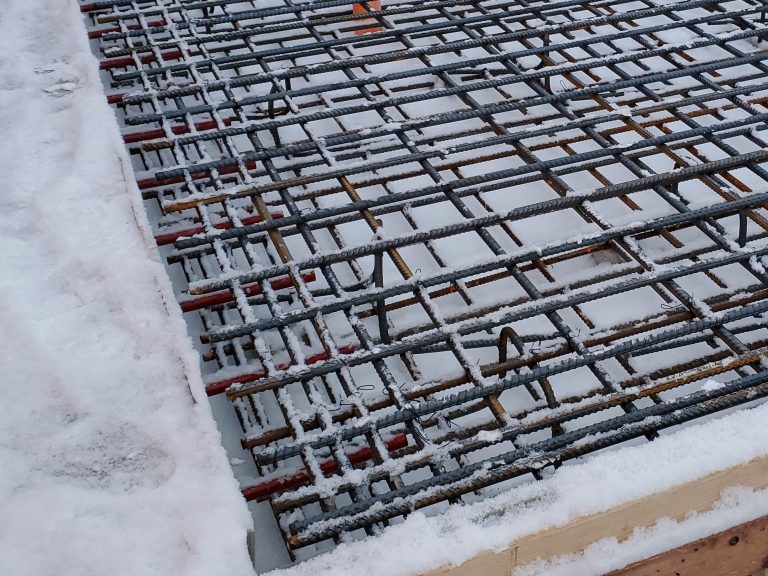

  • ·Removing Ice and Snow
The fresh concrete should not be poured on the frozen ground. Putting a cover and insulator is a way to prevent ice from falling on your work area. Frost blanket can be used as protection. The frozen ground will settle as it thaws, which will make your concrete risky for cracking. If ice has already fallen on the surface of the formworks and rebar, removing it before proceeding is important. Concrete that is placed on a cold surface will make the setting time longer.
Photo credit: www.fprimec.com

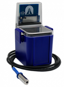

AKCP Wireless Temperature
Wireless Temperature Sensor
An early-stage investment is the foundation of your concrete’s long-term durability. Yes, the impact of cold weather concrete temperature monitoring is admittedly terrible from its earlier years. Today, as technology continuously moves forward, you may find options of monitoring solutions to serve your purpose. If you seek to protect your project’s quality, ask our sales representatives, and they shall be happy to tell you more about our AKCP Temperature Sensor.
AKCP Temperature Sensor is built-in with Calibration Check. Wireless Tunnel™ NIST2 sensors feature 2x NIST traceable, calibrated temperature sensors in a single stainless steel tube. Working as a pair, they check each other’s values once a second for accuracy. It provides you data that is needed in planning and implementing your cold-weather concreting strategies. Therefore, ensuring maximum protection from the threat of cold weather.
