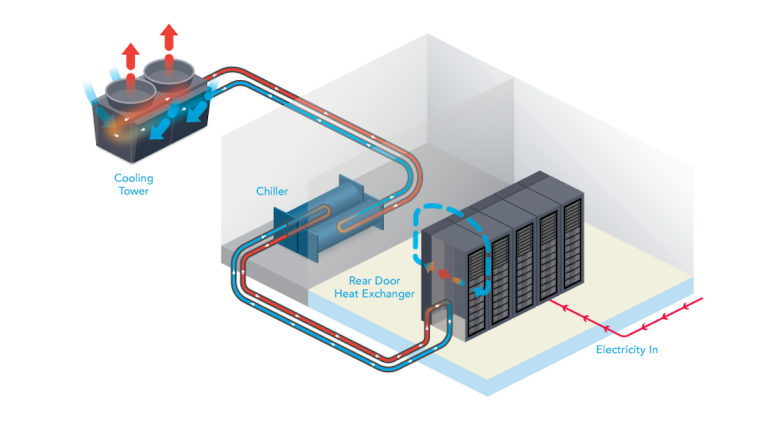

The Benefits of Water Cooling Systems Include:
  • An increase in server density is possible.
  • There is a significant reduction in the amount of energy required for cooling.
  • There is less time for manufacturing and a higher return on investment.
  • There’s no requirement for a unique building design.
  • Infrastructure that is more reliable,
  • There’s no need to re-characterize air flows before making any movements, additions, or modifications.
Photo Credit: www.upsite.com
Many data center operators have been concerned about possible leakage when using water cooling, but this technology has advanced to the point where this should no longer be an issueThe use of water to cool hotspots enables the future operation of high-density data centers. Water cooling is, in most cases, considered a best-practices approach. When “free cooling” is used during periods of colder weather, water-cooled technologies become even more efficient.
Cooling towers, in actuality, don’t keep things cold. They reject heat by moving heat from the water supply to the atmosphere via evaporation and sensible heat transfer, lowering the water temperatureBecause businesses utilize cooling water for a variety of purposes, cooling towers come in a variety of shapes and sizes.

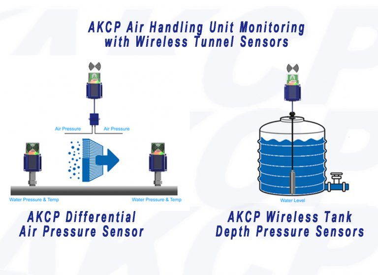

Air Handling Unit Monitoring with Wireless Tunnel Sensors
AKCP HVAC MONITORING SENSORS
In chilled water cooling systems having sufficient water in the cooling tower is essential. With wireless tank depth pressure sensors, you can easily monitor and be alerted if the water level drops below the required levels.
Flow meters can be installed to check for water loss, ensuring inflow and outflow are equal.
Differential Air Pressure Sensor installed on the Air Handling Unit Filter. When pressure drop across the filter is high filters are dirty and require maintenance. Sensors are wireless with 10-year battery life.
Wireless Pipe Pressure Sensors monitor the water or gas pressure and temperature on the input and discharge lines from the AHU.
