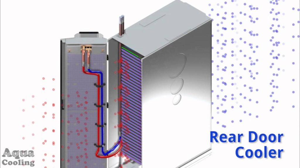

Rear Door Heat Exchanger (RDHx)
In principle, RDHx is designed to make efficient air cooling to a data center. It makes use of the cooling by-product from the transition of a liquid to gas. The cooling effect from the change is maximized by streaming the cold air close to the heat source.
RDHx functions are similar in principle to a car radiator. The rack rear doors are built with cooling fins. This way, the heat exhausted by the rack mounted hardware flows through the heat exchanger Some active heat exchangers have fans to help pull or push the air through. Other passive RDHx simple rely on the positive pressure made by the server fans. When the hot air passed through the cooling fins, the heat is exchanged by conduction from air to cooling fins. Refrigerant gases or cold water passing through pipes in the heat exchanger then carry this heat away
The heated fluid flows to a cooling distribution unit (CDU). The CDU is connected to an external water system. The water in the system is chilled, hence, changing the water temperature in the process.

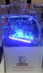

This cooling method puts servers lined up vertically in a coolant bath initiates the transfer of heat. The bath is made of electrically non-conductive fluid (dielectric). The direct contact of coolant to the server enables the easy transfer of heat.
When heat is transferred, it vents on top of the racks. After exit, heated coolant will circulate through the CDU. The CDU is connected first to a warm-water loop. The loop functions as the final gateway for heat removal. It has existing chilled water to transition the warm liquid to a colder one.
Ultimately, once the cool liquid is achieved, it returns to the data servers through the same heat exchanger. Single-phase immersion cooling is considered to be a straightforward cooling option. As a direct benefit from its simple mechanism, it makes it more affordable, user-friendly, and does not require a rigid maintenance process.
