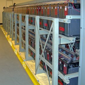

  • Batteries
The most common source of backup power. Batteries can supply DC power. Lead-acid batteries get electricity from the grid power source. They are and stored electricity so that facilities may use them in case of a power outage. The number of power batteries can supply depends on how much electricity is stored in them.

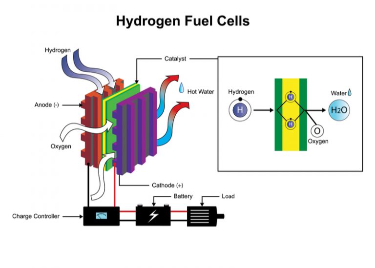

  • Hydrogen Backup Power
This is also known as fuel cell backup power. They are powered by hydrogen. They utilize the proton-electron membrane (PEM) technology to supply DC power. Hydrogen backup power can function even at low temperatures. They also have a quick warm-up period and are smaller than other fuel cells.

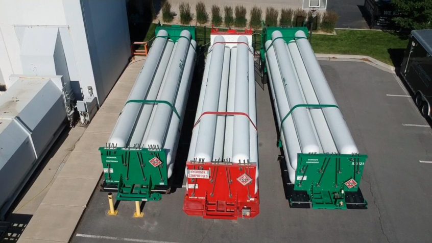

Microsoft’s Hydrogen Backup Power
In 2020, hyperscale company Microsoft started to explore the potential of hydrogen backup power. The company’s aim is to be carbon negative by 2030. Through research, they successfully powered a row of data center servers for 48 consecutive hours all by using hydrogen fuel cells.
Diesel generators are an absolute necessity to be able to have five-nines of availability at data centers. A lot of data centers keep 24-to-48 hours of fuel on-site.
Diesel generators are noisy and produce, not just carbon, but also particulates, including nitrous oxides. Not to mention that its getting harder to get a permit at the levels that some hyperscale companies are moving.
From then, Microsoft started to look for alternative power sources. One that would replace diesel technology but can maintain – or even improve – the availability and reliability of such power sources. Hydrogen fuel cells proved to be an effective subject for this technology.

Hydrogen backup power has many benefits compared to other types of backup power. For one, they generate power through chemical processes which does not include the burning of fuel or combustion. Pure hydrogen does not emit pollution. It only produces heat and water as by-products.

Wireless Tunnel™ Battery Monitoring sensorPermanent damage might occur if the battery temperature is not monitored and correctly maintainedAt best, there will be some mechanical deformation or a change in the chemical composition, requiring a pricey battery replacementIn the worst-case scenario, the battery cell could break, explode, leak chemicals, or catch fire.
The negative terminal of the battery frequently shows signs of increased battery temperatureThe temperature should not rise more than 3°C above the ambient temperature when normal operating circumstances are appliedTwo temperature sensors can be used, one to monitor the ambient temperature and the other to monitor the negative terminal of the batteryThe difference between the two sensors can then be utilized to detect potential battery health problems or circuit faults.
Battery Monitoring System
A simple manual battery temperature monitoring system would be to have someone physically check the battery string once or twice a week. An IR temperature gun can do this, and you can record the data in a spreadsheet. Remember you are looking for not more than a 3°C difference between the battery and ambient temperature.
In these days of automation, why not install a permanent 24/7 battery temperature monitoring system? The most basic is a temperature sensor installed on the negative terminal post of the battery. You will have a graph of the temperature, and with the addition of an ambient temperature sensor, the two can be plotted on the same graph and the ∆T shown. More advanced battery monitoring systems can monitor individual cell temperatures, charge current, voltage, and load current and voltage.
