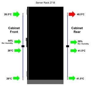

server-rack-2
HIGH AIR OUTLET TEMPERATURE INDICATING HOT EQUIPMENT
Server Temperatures
By monitoring the air temperature at the exit of your cabinet, you can see how well your cooling is performing, and how hot your equipment is running. A high outlet air temperature can indicate inefficient cooling, an overloaded server or failure of a fan or cooling system in the server itself.
