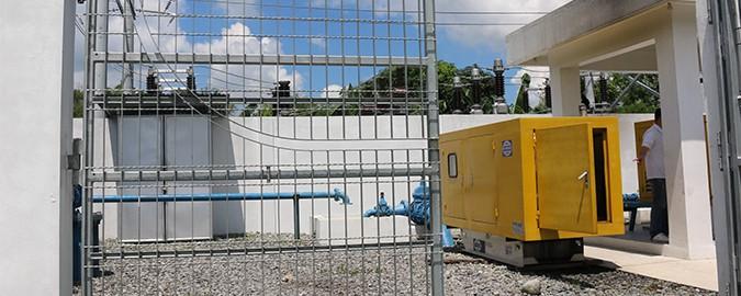

Typical pumping station site, one of 32 around Clark that were installed with AKCP monitoring solutions.

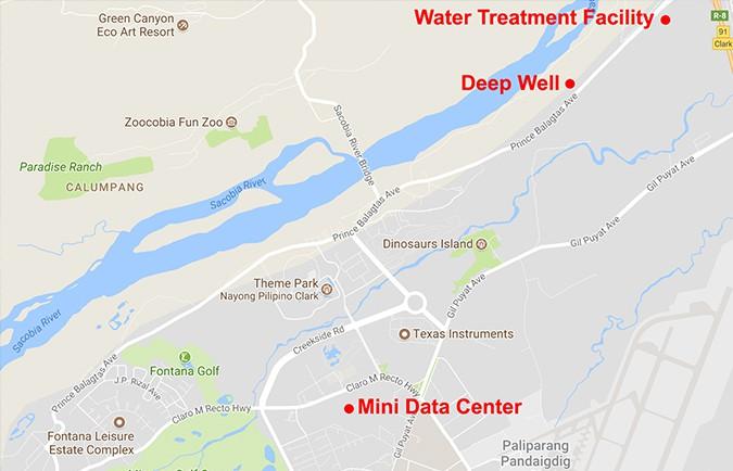

Location of sites referenced in this case study.

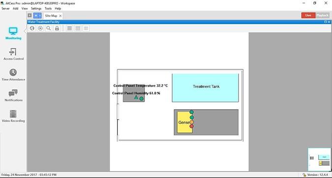

AKCPro Server, AKCP’s central monitoring platform, was installed at the main control room office to provide centralized monitoring and management of all sites. Custom dashboards were set up to display data from the generators and sensors installed at each location throughout Clark. Virtual Sensors were used to monitor the status of UPS backup power systems, as well as the SCADA system for controlling of pumping stations. ONVIF IP cameras were interfaced with AKCPro Server as well as access control for sensitive areas.

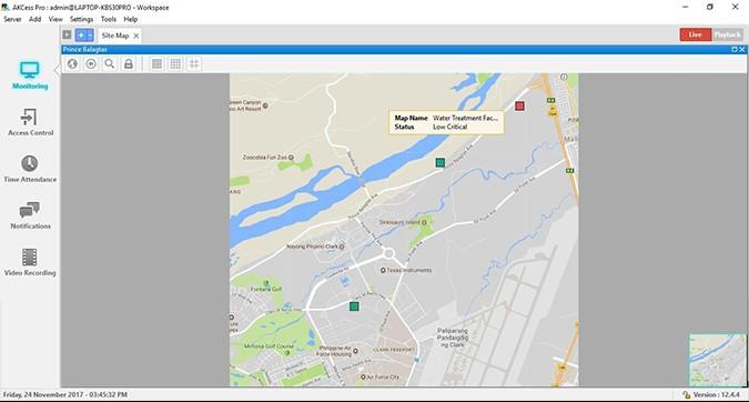

With Drill-Down Mapping, AKCPro Server was able to give a visual overview of all sites, and their status at the central control room, making monitoring the situation of each location simple.
AKCPro Server is also used to manage all deployed devices, updating the firmware, configuring the devices, backup and maintenance can all be done through this software.
Drill down mapping of sites in AKCPro Server
Customized desktops were setup for each site to display the sensors and generator data.

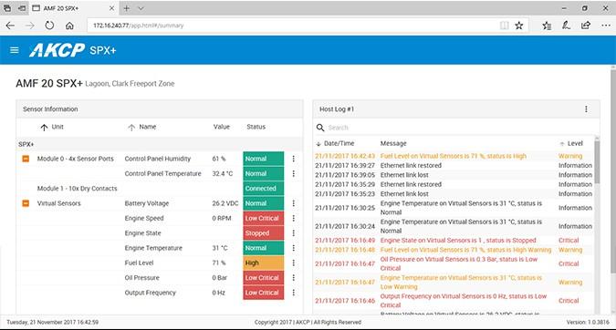

A larger site than the pumping stations, this was equipped with a larger Cummins genset with ComAp IntelliLite AMF20 control panel. An RS485 Modbus connection was made from the SPX+ to the control panel, enabling AKCP to monitor the engine parameters remotely. Oil pressure, battery voltage, engine temperature, fuel level, engine speed, runtime and engine status, were programmed using the relevant Modbus registers in the SPX+. This allows Clark Water to closely monitor the generator’s status, as well as scheduled preventative maintenance when a specific number of hours runtime is reached for example.
SPX+ with 3G modem and 10x dry contact I/O module installed at generator control panel.
ComAp InteliLite AMF20 control panel provides RS485 connection to the SPX+. Due to the distance from the main control panel room and the generator, which was located in an outb
Due to the distance from the main control panel room and the generator, which was located in an outbuilding, the SPX+ was connected via a WiFi network connection, and then to the wired network infrastructure already in place. The cellular data modem provides an extra layer of communications, by sending SMS alerts in critical situations.
Screen capture from SPX+ web
