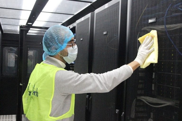

For data centers, the cleaning personnel must be professionals who follow strict procedures and handle the cleaning with great care, since they will be working around very sensitive and expensive equipment.
Vacuum cleaners with HEPA filters should be used during cleaning, to prevent any dust or dirt particles as small as 0.5 microns to get airborne, and end up in the servers and other sensitive equipment with the intake air.

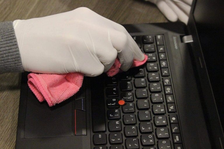

- Dell recommends the use of a microfiber fabric cloth moistened with 70% isopropyl alcohol for cleaning frequently touched sensitive IT equipment.
For DIY cleaning, also keep in mind the following precautions and recommendations:
- Cleaning must be limited only to external surfaces such as handles, key pads and other common points of contact. Do not open cabinet doors and server chassis, or attempt to clean any internal components.
- Never spray any liquids directly onto or into any equipment. Use moistened microfiber cloth or other appropriate cleaning material. Do not allow any moisture to drip into any areas.
- When cleaning displays, carefully wipe in one direction, moving from the top of the display to the bottom.
- Fiber optic cabling should not be removed for either the general-purpose or disinfectant cleaning, due to the increased risk of debris contamination.
- If the IT equipment must remain operational while the external surfaces are cleaned, use extreme caution in exposing powered equipment to any moisture. Take all proper and necessary precautions when handling any powered equipment that has been exposed to moisture. Be careful not to accidentally unplug any wiring.
- If the IT equipment can be powered down, remember to follow the proper shutdown procedures. After cleaning, all surfaces must be completely air-dried before powering up the equipment. There should be no moisture visible on the surfaces of the equipment before it is powered on or plugged in again. Re-check all wiring and connections before powering on.
