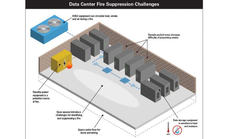

Rarely do fires occur inside Data Center facilities. If there is, the fire suppression systems inside should take care of it. The problem here is that the fire solution itself could be as devastating, if not more so, than the fire.
With that in mind, there is a universal requirement for fire suppression equipment in Data Centers all over the world. Keeping the Data Center safe from a devastating fire can be challenging. It’s not like purchasing and installing a few fire extinguishers in locations all over the building. Data Centers have delicate equipment and heat-generating components that could burst into flames spontaneously. Also, Data Centers have people working inside the facility whose lives are in danger. Saving them is the topmost priority, with the second priority being the computer equipment and the building itself.

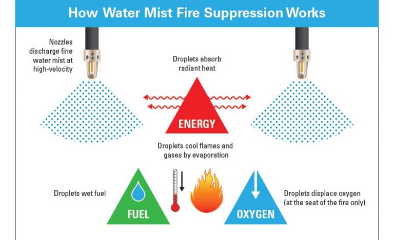

Water mist consists of finely atomized water droplets. A high-pressure water mist system produces water droplets, 99% of which measure less than 100 microns in size. These tiny droplets provide a larger surface area for heat transfer. This causes more of the water mist to be vaporized into steam, giving off radiant heat, increasing the cooling effect, to extinguish the fire.
Since water is vaporized during the suppression process, the water mist does not reach the systems’ critical assets, thus minimizing the damage. These systems do not require large amounts of water, as opposed to conventional sprinklers. This is practical especially in locations with limited water supplies, or where municipal water pressure is low. Since the old sprinkler systems rely on using the same water supply as fire hydrant lines (water that can contain sediment and other impurities), water mist systems use potable water which is free of contaminants.

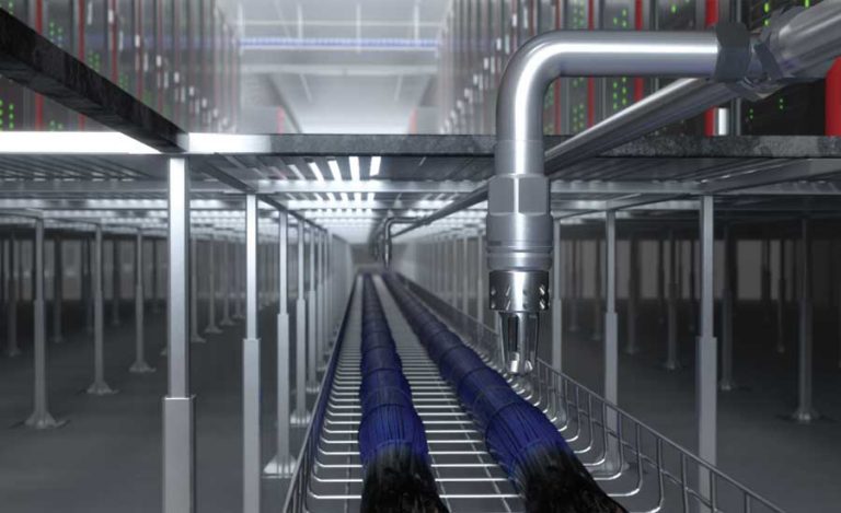

Instead of protecting an entire data facility, fire suppression systems can be built to protect a smaller, localized part, or specific equipment inside the area. This saves money over building an entire total-flood suppression system.
Local targets within a Data Center can include areas with potential fire sources, such as HVAC, power and communication cables (often located in subfloors or above floor cable trays) and power rooms (including backup generators, UPS, and battery rooms).
During the design and installation of a localized water mist system, closed, fusible-link, discharge heads must be carefully chosen and positioned to provide maximum coverage. Calculations should include consideration for activation temperature, flow, and distribution patterns for the concerned area. In the event of a fire, the system should only deploy water mist in the spaces where a heat signature is detected.
