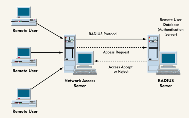

RADIUS AUTHENTICATION AND AUTHORIZATION FLOW (IMAGE SOURCE: WIKIPEDIA)
As an overview, a basic RADIUS Authentication and Authorization process include the following steps:
  1. The user initiates authentication to the network access server (NAS), providing the user credentials.
  2. The NAS or RADIUS Client sends the given username and the uniquely encrypted password to the RADIUS Server for verification – this is the Access-Request message.
  3. The RADIUS Server verifies the user credentials against the user database, and accepts or rejects the user.
  4. If there is a match and the user is accepted, the RADIUS Server extracts additional details from the user database for any configured access or privilege policies.
  5. If there is a matching policy, the RADIUS Server sends an Access-Accept message with the Shared Secret back to the device, and the user is allowed access.
  6. The Access-Accept message consists of a string of text, including a Filter ID attribute. This Filter ID can be used to further granulate user access via groups and additional policies.

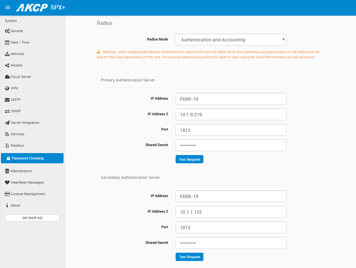

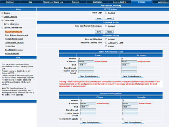

RADIUS implementation on AKCP devices
sensorProbe+
RADIUS is supported on F7 platform units only. Both IPv4 and IPv6 network addressing is supported.
You can define a total of 4 authentication servers, and 4 accounting servers.
There is a fallback logic when a primary server is unreachable, the device will try to reach the other defined servers. If all servers are unreachable, the unit will fall back to using the built-in local user database (Admin/User/Viewer accounts).
Using RADIUS requires a separate license on SP+ devices.
Note: To be able to fully manage the unit when RADIUS is enabled, create an account named Admin in the RADIUS user database. This is necessary because, in the current implementation, SP+ units cannot handle RADIUS user groups and will authenticate users as a read-only “User” account only.
securityProbe
RADIUS is supported on securityProbe. Both IPv4 and IPv6 network addressing is supported.
You can define a total of 2-2 authentication and accounting servers.
There is a fallback logic when a primary server is unreachable, the device will try to reach the other defined servers. If all servers are unreachable, the unit will fall back to using the built-in local user database (Admin/User accounts).
Using RADIUS doesn’t require a separate license on SEC5 units.
Note: To be able to fully manage the unit when RADIUS is enabled, create an account named Admin in the RADIUS user database. This is necessary because, in the current implementation, SEC5 units cannot handle   RADIUS user groups and will authenticate users as read-only. For handling different user privilege levels, the SEC5 unit’s built-in users and groups management have to be configured (covered in a separate manual).
