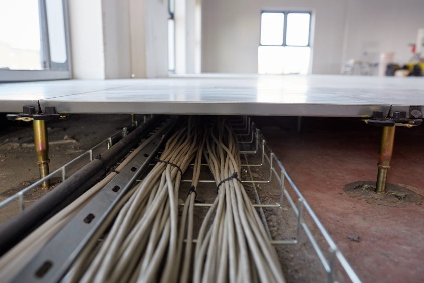

Regardless of the many advantages of raised floors,  still accounts for many data center cooling problems. Uneven air pressure and spotty air delivery are commonly caused by air turbulence. Some buildings also do not have the slab-to-slab clearance for the height requirements of raised floor type data center.
The space under the raised floor is used for cabling which becomes an obstruction for air cooling. Therefore, proving a raised floor design is not fit to accommodate higher-density rack deployment (8kW–10kW per rack and up).

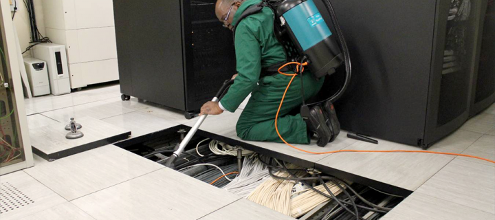

To protect data center investment in this kind of environment, proper maintenance must always be followed. Below are the proper raised floor maintenance and care:
  1. Dust or vacuum the floor daily.
  2. Damp-mop only with warm water and mild multipurpose ammoniated floor cleanerDO NOT use excessive water, Large amounts of water can weaken adhesive and cause de-lamination.
  3. Do not use abrasives, scrapers, or strong solvents to remove stains. DO NOT use the wax seal on the laminate surface.
  4. Have your Raised Flooring System professionally inspected and cleaned by a professional raised access floor maintenance technician once a year.
  5. Vacuum under-structure and subfloor at least once a year.
  6. Clean air flow and perforated panels twice a year.
  7. Vacuum carpet panels twice a week with a static dissipating vacuum.
  8. Clean carpet Raised Flooring System with dry foam/powders at least twice a year.
  9. Utilize runners and mats in high traffic areas.

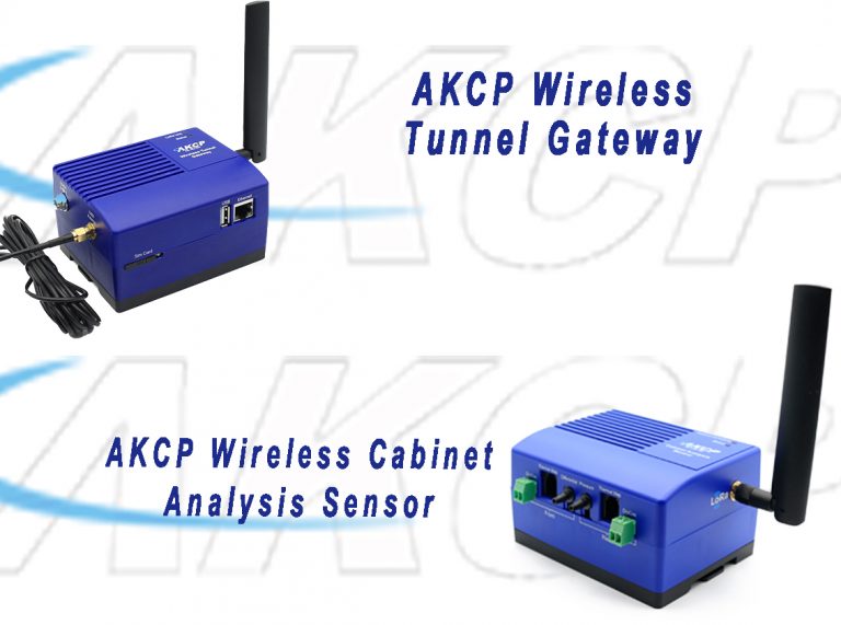

AKCP Wireless Sensor and Gateway
Wireless Cabinet Sensor
The W-CAS has a cabinet thermal map for detecting hot spots, a differential pressure sensor for airflow measurement, and two dry contact inputs for door security sensors. Data is captured and delivered to one of our wireless sensor gateways.
