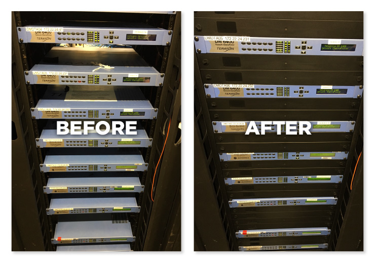

When designing a data center, you’ll want to consider how your server racks should be organized. Blanking Panels are a piece of equipment in IT racks that many people ignore. It is usually a piece of plastic or metal that is inserted into an empty rack space, available in 1U or 2U configurations. Sometimes with brushes to bring cables from front to rear. They will remain in place until a new server or another piece of equipment is installed in its place.
AKCP Blanking panel. Metal 1U panel with cable brushes
They are essential when your data center has hot or cold aisle containment. Some data center administrators wonder if they are worth the expense, as they will simply be removed later. The truth is that there are several important reasons why a server rack’s vacant slots should be filled in. You’ll immediately see that they’re worth every penny once you learn their advantages.

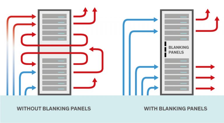

Proper Server Rack Airflow
Photo credit: www.stulz.de
Modern server racks are designed to ensure that air flows evenly, allowing for effective cooling of the servers and rack-mounted equipment. This design, on the other hand, only works when all of the slots in the server are occupied. If there are empty slots you can have wasted cooling through bypass airflow, and recirculation of hot air from the rear to the front air intake.
  • Creating ‘Dead’ Spots
If the rack has an open U, the airflow, taking the path of least resistance may flow through the open U in preference to through the servers. This can result in ‘dead’ regions where the air doesn’t move or flow slowly. As a result, a hotspot develops, which may cause equipment issues.
  • Air Pulling from the Opposite Side
The opening may allow air to flow from one side of the rack to the other. Hot air, expelled at the rear of the rack can recirculate back to the front, decreasing the effectiveness of the cooling.
  • The ‘Tornado’ Effect
This occurs when air collides with an unanticipated opening and blows in the other direction resulting in an area in the rack where the air spins in place instead of blowing out. This causes the cooling effects to be disrupted.

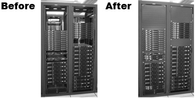

Improved Aesthetics
Photo Credit: www.energystar.gov
The first thing people will notice about a server rack with blanking panels is how much nicer it appears than a rack with only apertures. While appearances aren’t the most significant factor when it comes to storing computer equipment, they are worth mentioning. For most businesses, ensuring that the equipment looks nice will help to wow clients. For others, it will merely demonstrate that the racks are appropriately configured for efficient airflow, which is something that all IT experts understand is critical.
