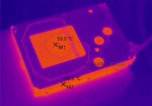

Hard Disk Drives (Traditional Magnetic Storage)
Optimal Temperature Range for Hard Disk Drives
Although most hard drive manufacturers specify a nominal operating temperature range of 0°C to 60°C (32°F to 140°F), it’s essential to recognize that this range may not be optimal for ensuring reliable and secure operation. Exposure to prolonged temperatures below 20°C (68°F) or above 50°C (122°F) can detrimentally impact the drive’s longevity and effectiveness.
For environments characterized by ambient temperatures lower than 5°C (41°F) or exceeding 50°C (122°F), the selection of enterprise hard drives becomes imperative. These specialized drives are engineered to withstand a broader temperature range and ensure consistent and dependable performance.
Negative Consequences of Temperature Extremes
When hard drives operate in excessively high or low temperatures, they are susceptible to various mechanical and electrical issues, such as head misalignment, condensation, and circuit board malfunctions. It’s worth noting that cooling hard drives excessively could paradoxically lead to increased failure rates compared to those running at slightly elevated temperatures, as indicated by a Google HDD study.
Elevated temperatures can significantly curtail a hard drive’s lifespan. Research from National Instruments revealed that even a mere 5°C (9°F) temperature increase could reduce a hard drive’s life expectancy by up to two years.
Temperature-induced performance degradation is also a concern. Contemporary hard drives incorporate protective measures such as throttling read and write speeds when the temperature surpasses a critical threshold (typically around 60°C or 140°F). Consequently, performance can plummet to as low as 1 MB/s until the drive cools down, as observed in a test conducted by Anandtech.
Based on these considerations, our recommendation for optimal hard drive performance while in operation is a temperature range of 20°C (68°F) to 45°C (113°F).

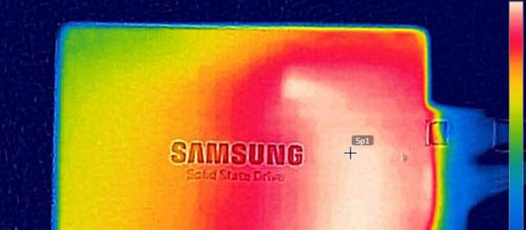

Solid State Drives (SSDs): Flash Memory Storage
Optimal Operating Temperatures for SSDs
Solid State Drives (SSDs) possess distinct characteristics that render them susceptible to temperature variations despite their lack of mechanical components and reduced power consumption. SSDs generally operate at temperatures exceeding those of conventional hard drives by approximately 10°C. Manufacturers rate most SSDs for operation within a temperature range of 0°C to 70°C (32°F to 158°F).
M2 SSDs and PCI-E SSDs exhibit unique thermal considerations due to their exposed memory and controller chips operating at high bandwidth and speed. Enhancing cooling through heat sinks and ensuring proper case ventilation is advisable for these SSD types.
Temperature’s Impact on SSD Longevity
Studies from entities like Facebook and Digitaltrends underscore the correlation between elevated SSD temperatures and accelerated flash memory wear. This is especially relevant for data centers requiring 24/7 SSD operation.
To ensure SSD reliability, it is prudent to maintain an operating temperature range of 30°C to 50°C (86°F to 122°F). Intermittent temperature spikes of 5-20°C during normal read-write operations are expected. Under heavier workloads, transient temperature increases are common.
Thermal Throttling and Performance Safeguards
SSDs, similar to modern HDDs, implement thermal throttling as a protective measure against overheating. When an SSD approaches its manufacturer-set limit of around 70°C (158°F), it automatically slows down to prevent damage. Performance is restored as the temperature drops to a safe range, typically around 50°C (122°F).
