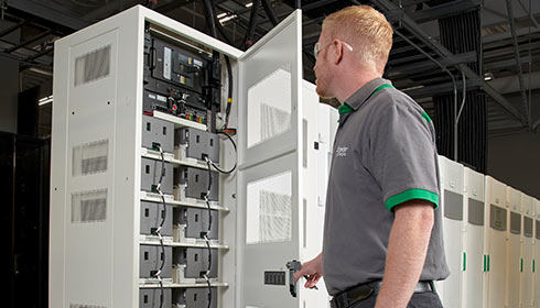

Batteries work in harmony with rectifiers and inverters. They are an integral part of a data center’s UPS. In the event of a main power source failure, they serve as the primary backup to keep electronic equipment running. Failure of batteries in data centers could result in a power interruption that can stop operations. This could lead to a huge financial loss for the business.

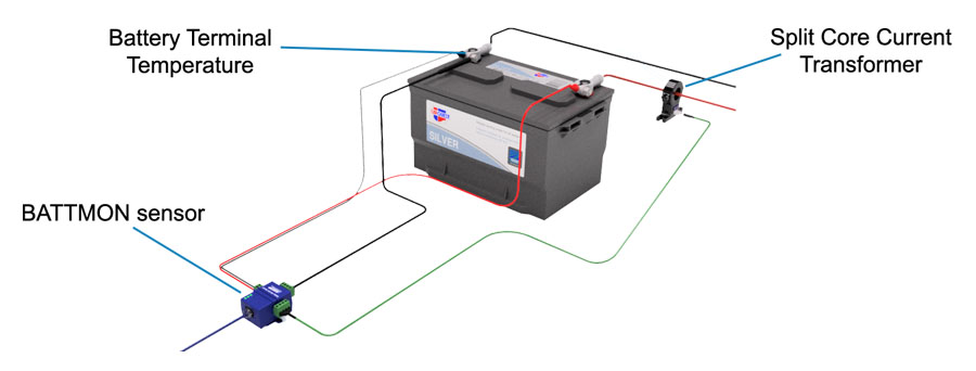

Battery systems are comprised of cells, cables, and more. They are interconnected, and a failure in one part can lead to an overall reduction of a battery’s performance. It is vital for data centers to have reliable battery monitoring health and ensure proper handling and storage. AKCP has a battery monitoring system for checking battery health. Determine battery efficiency and power output. The battery monitoring system can individually monitor battery temperature, voltage, current, and wattage. It can also monitor each battery cell or bank of batteries. This would better predict potential failure and notify managers to replace the batteries before a failure occurs. Always remember that a monitoring system should always be included when you think of investing in this type of battery.

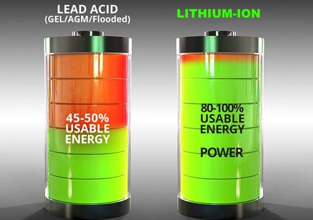

Data centers have strived to improve their power density in recent years. This is brought on by the limited space and need for more efficient operations. One of the main challenges for data center owners is ensuring the efficient use of the available space. The use of compact lithium-ion batteries lessens the occupied space of a UPDS by 50-80%. These batteries do not need much charging time, and they also have a better self-discharge rate. These features are especially crucial in the event of power outages. An idle lithium-ion battery loses around 1-2% of its charge monthly. However, the most important advantage of Li-ion batteries is their long service life. Lead batteries have a shorter life cycle, having a life span of only 3 to 6 years. On the other hand, Li-ion batteries last around 10 years. They have the ability to have a max charging efficiency of up to 5,000 cycles depending on the chemistry, temperature, and technology. Meanwhile, lead-acid batteries only have 700 life cycles.
Photo Caption: everspring.net/
For a period of 10 years, the total cost of ownership has decreased by 39% compared to lead-acid batteries. It is important for li-ion to have reliable battery monitoring systems to allow better safety and performance. Li-ion batteries also have the ability to operate at higher temperatures than VRLA batteries without sacrificing performance. This decreases the load on cooling systems. Several models are available to cater to different needs, which can be used in large data centers, industrial applications, and small server rooms.

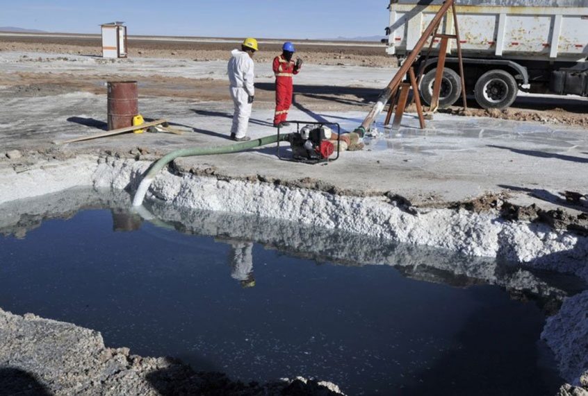

Lithium can mostly be located in pristine salt flats in the areas of Argentina, Chile, and Bolivia. In their extracting lithium, companies have been accused of exploitation in local populations, extraction of excess water, and damaging untouched habitats. Meanwhile, for cobalt, most of the world’s reserves are in the Democratic Republic of Congo. Mining companies in these areas have been accused of exploiting child labor as well as grave health and safety violations.
