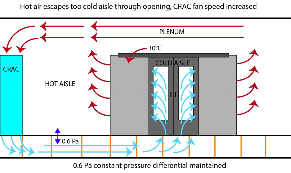

An alternative method of control is through a temperature sensor. In this method, the pressure difference between the cold and hot aisle is kept as close to 0 Pa as possible. A very slight positive pressure may be present to prevent backflow of hot air. However, with proper containment, the server fans themselves will generate sufficient pressure to prevent this occurring. In this method of control, the servers are sucking exactly the amount of air they need, and nothing more.
A temperature sensor placed at a small opening in the containment aisle measures the temperature of the air flowing through. As server loads increase, the server fans will suck more air. If the CRAC is not able to supply air fast enough, the air will be sucked out of the cold aisle quicker than it is replaced. This leads to a positive pressure differential between the hot and cold aisle. When this occurs, hot air will begin to flow back into the cold aisle through the controlled opening. The temperature sensor at this opening will measure this increase and signal the CRAC to increase its fan speed.
How then do you prevent overcooling in this system? The CRAC fans after being increased in speed will constantly decrease at a slow rate until again the temperature sensor detects an increase in temperature.

It can not be ruled out that in a pressure controls system the cold air supply can not keep up with the cooling requirements of specific cabinets. Depending on where the pressure sensor is located, some cabinets may require more cooling at a given time than another. By placing temperature sensors one each cabinet, the worst case can be used as the control point.
If we first consider the pressure control system. By maintaining a 20 Pa positive pressure in the cold aisle at all times, you are potentially overcooling the system, by supplying a higher volume of air than is actually required by the servers. In addition, no containment system is perfectly sealed. There will always be openings and gaps for cables and movable parts. If these gaps are taken into consideration, there will be higher cold air losses trough these gaps in a positive pressure system than in an even pressure system.
