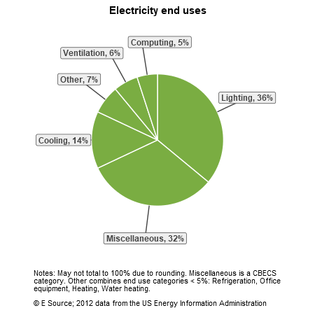

Non-refrigerated warehouses in the United States use an average of 6.1 kilowatt-hours (kWh) of electricity and 13,400 Btu of natural gas per square foot annually (E-Source research and advisory service that works with most of the 300 largest electric and natural gas utilities in North America). Lighting and space heating account for approximately 76% of total energy use in such warehouses, making these systems prime targets for energy savings.
In a non-refrigerated warehouse electrical costs typically account for 15% of the operating budget. In refrigerated and cold storage warehouses, up to 60% of the operating costs can be accounted to the electrical use. The chart opposite shows the typical energy usage breakdown for a non-refrigerated warehouse. Lighting accounts for the largest proportion of energy used in the warehouse.

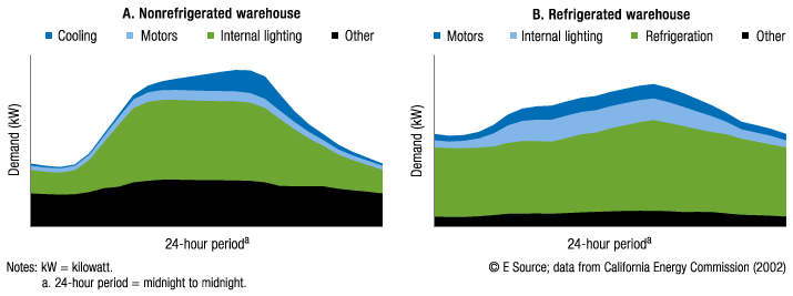

Understanding how your energy provider charges for your power consumption is the first step to reduce warehouse energy costs. Utilities charge commercial buildings for natural gas based on the amount of energy delivered. They charge for electricity based on consumption and demand. The consumption component is calculated on the amount of electricity the building consumes in a month. The demand portion is based on the peak demand in kilowatts that occurs within the month. Some utilities determine the peak demand based on the previous 12 months.
The peak demand charges can quickly increase your bill. The below chart (courtesy of https://ouc.bizenergyadvisor.com/article/warehousesillustrates the typical peak demand of a non-refrigerated and refrigerated warehouse. You can see that in a non-refrigerated warehouse the peak demand curve is much steeper than in refrigerated. Whereas a refrigerated warehouse consumes a more consistent amount of energy, non-refrigerated consume much less during the night time hours than during daylight hours. Cooling accounts for the largest peak demand in both instances, although lighting in non-refrigerated warehouse makes the largest contribution to peak demand levels. Taking measures to reduce your peak demand has significant impact on your costs. The Mirage Hotel and Casino in Las Vegas made huge savings by installing VFD’s on their refrigeration chilled water system. Not only did the VFD’s reduce energy consumption but they also ramp up the motors when starting up reducing the peak demand dramatically. It can be useful to employ the services of utilities and energy consultancies to review your energy use and advise on areas you can save on energy consumption in your warehouse.

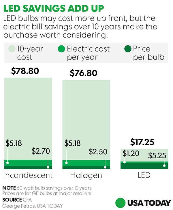

As we have seen, lighting is one of the biggest energy hogs in the warehouse. This makes it the prime target for energy saving measures. Lighting technology has improved over recent years resulting in a shift away from typical high ay lighting systems of old that used Fluorescent Tubes and Metal Halides. LED lighting technology for the warehouse offer many advantages.
  • Longer life
  • Better light distribution pattern
  • Improved cold condition performance
  • Lower energy usage
LED lighting have a faster startup time and less degradation through power on/off cycles when compared with traditional lighting systems. This makes LED lighting better suited for control via occupancy and motion detection sensors. Typically upgrading to LED lighting systems can save 30% of your energy costs.

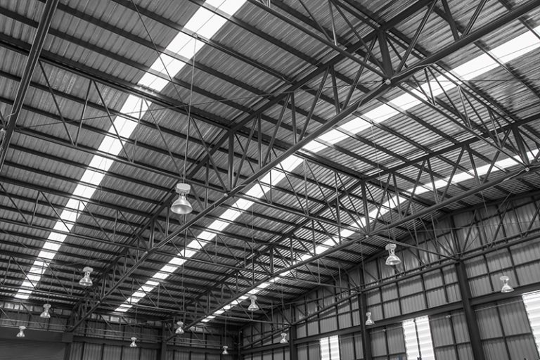

Another strategy employed by many warehouses is the use of skylights that bring in natural and free daylight. These can be paired with timers that control the interior lighting. So during daylight hours the natural skylights are sufficient, and as night time approaches interior lighting systems are turned on. This means you no longer rely on employees to remember to turn lights on and off.

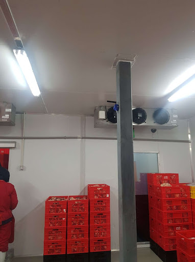

Customer Story – Cold Storage Temperature Monitoring
AKCP Monitors Cold Storage for Naivas
