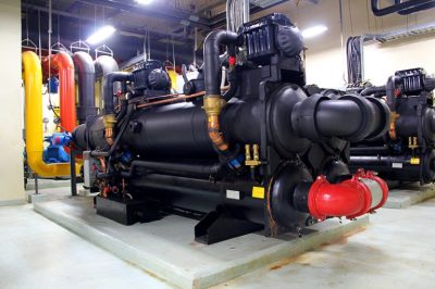

Chilled Water System. Centralized cooling of the data center hall, commonly deployed in mid to large sized data centers. Chilled water cools air that is brought in by the Computer Room Air Handlers (CRAHs). The chilled water is supplied by the Chiller Plant located in another area of the data center.

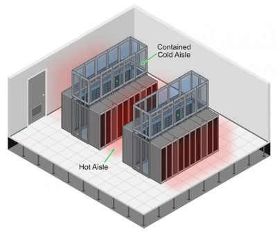

Hot / Cold Aisle Design. This is a common design method used in modern data centers. The cabinets are arranged in alternating hot and cold rows. The cold aisles are cooled so the servers can draw in the cool air. The hot air is expelled to the hot aisle. This stops the hot air mixing with the cold air. The hot air is then removed and returned to the cooling system to remove the heat from the air before being returned to the cold aisle.

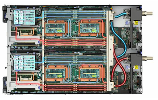

Direct To Chip Cooling. This method of cooling is one of the malt efficient in terms of cooling servers. It utilizes a network of pipes that deliver cooled water to a cold plate that is incorporated to the main board of the server. The metal plate acts as a heat sink, extracting heat from the chips and the cooled water carries this away to the chiller plant.

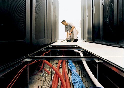

Raised Floor Leakage. Raised access flooring were popular method of data center design with cold air and callings being delivered through ductwork underneath the raised access flooring. If the raised flooring as leaks it can cause a loss of pressure as well as allowing dust and humidity to enter the cold aisle. Pressure differential sensors can be used to monitor for leaks.
