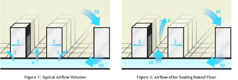

Having raised floor tiles: If the facility has a hot and cold aisle layout in place, putting raised floor tiles in cold aisles can increase airflow, helping with the cooling. Generally speaking, raised flooring do not have the same benefits in hot aisles.
Implement data center HVAC: when air flows throughout the facilities, it is worth noting that warm and cold air should not mix. Allowing hot air to absorb the cold air makes it more difficult for the cooling system to work, which is against the principles of air-based systems. By using curtains or barriers to prevent mixing, aisles retain their constant temperature and run more efficiently. It’s important to note that either hot or cold aisles should be isolated, while shielding both generally will not offer any benefit over shielding only one.

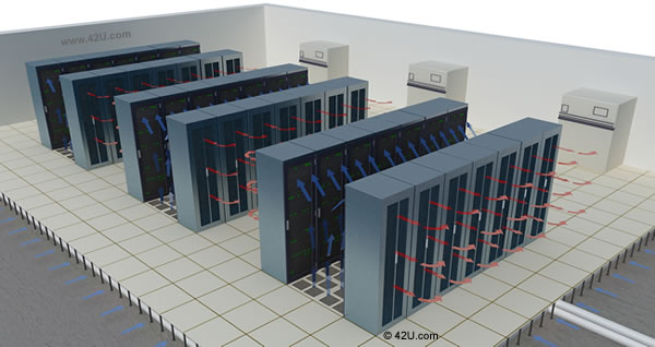

Hot and cold aisles are the most popular cooling layout for data centers. A server is designed to draw in room air through the front, cool necessary components, and then expel the hot air out the back. Understanding this, it is clear that putting the front of one server near the back of another server will draw in already-heated air. This process fails to provide the required cooling while also warming the air in the room as a whole.
To solve this, engineers and technicians arrange rows of servers in hot and cold aisles. Two servers will face each other across an aisle, providing a pathway intended only for cool air, which the servers draw in. Then, the back of the machines will form an aisle facing the back of other devices as well, expelling hot air from both into the same area. In this way, hardware only draws in cool air from the cold aisle. Warm air can be cooled adequately before being recirculated to the servers.
