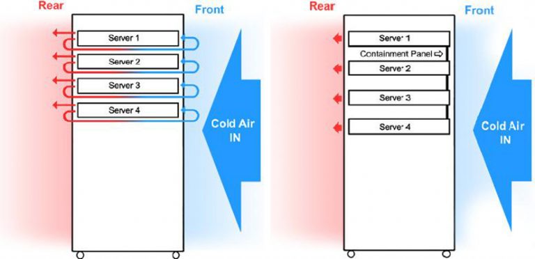

A rack blanking panel is sometimes referred to as a closeout filler panel. It’s a rectangular piece of metal or plastic that can be screwed on an empty spot on the rack. A blank panel covers the unused space until a server is set to occupy it. At that point, the blanking panel needs to be taken out and the server comes in. This material is used on all the empty rack spaces in the data centers.
Server rack blanking panels come in many sizes depending on the size of the empty space. The smallest is 1U and it’s equivalent to the size of one rack unit or one server. Some can be as large as 6U’s.
When blanking panels are installed correctly, they prevent hot air from recirculating back to the gap. Without rack blanking plates, heat may travel to empty spaces heating the closest servers above and below. Two things can happen. Either heat can damage the servers or fans might have to work harder to eliminate the heat. Both will result in increased energy usage and lower efficiency.

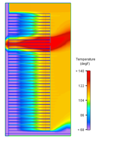

The question is, do they really work? Or Is it just a waste of money and time? To answer this, Dell, one of the world’s biggest data center companies, researched the effectiveness of blanking panels and published the results in their white paper.
Their conclusion? It works. Using Computational Fluid Dynamics (CFD), they traced the movement of heat in an uncovered rack space. The computerized image below shows the side view of the rack. It’s evident that temperatures exceeding 50°C (122°F) can recirculate to the empty 1U space and then heats up the adjacent servers.
This process can prompt the fans of the nearest servers to overwork to compensate for the additional heat. Again this consumes more unnecessary energy that could have been avoided with a simple filler panel.
Let’s compute for the additional energy use. In this study, Dell used PowerEdge R610 servers. This server typically consumes 22 watts of energy. Using the facility’s Power Usage Effectiveness (PUE) or simply the ratio of the energy spent to the actual energy used by the servers, and the energy cost of $0.10/kW-hr, the additional annual energy required to power these server fans costs $39. The cost can even rack up to $300 for older units of fans and servers.

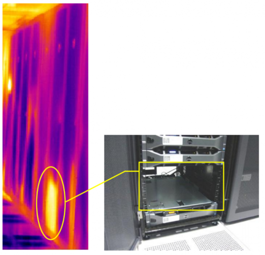

This study focused on a single rack unit. Several empty racks without blanking panels can contribute to high temperatures in the data center overall. The facility will then be compelled to operate at even lower temperatures. This might seem unnoticeable for months, but annually speaking, this is a dramatic increase in energy use.
Although fans can compensate for the heating of adjacent servers, empty spaces can be a ground for the increase in inlet temperature. The nearest servers will get hot faster than the other servers and can get damaged over time. The image below shows how heat can concentrate on the empty rack spaces. Also notice how filled rack units have no visible high temperatures.
blanking-study-heatmap
