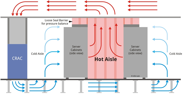

Ensuring Efficient Airflow
By placing temperature sensors at both the front and rear of the rack, you can check the inlet and exhaust air temperatures. The different between the two is known as the Delta T value (∆T). When the difference between inlet and exhaust temperatures is too great, it can signify that exhaust temperatures are rising and cooling is not working efficiently. Monitoring inlet temperatures ensures cold air is getting in, and monitoring exhaust temperatures ensures it is doing its job to cool the servers. AKCP Thermal Map Sensors monitor rack inlet and exhaust temperatures and calculate ∆T for you.
