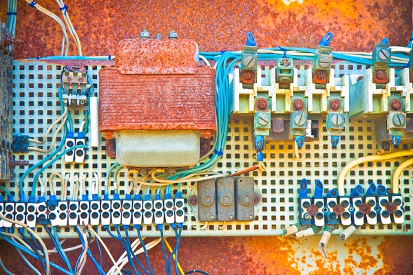

Humidity Causes Corrosion
Sites, where the atmosphere is hot, should always be watchful for shifts in the level of humidity. This is particularly true in cases where fluctuations cause temperature differences. Fluctuating levels of humidity heighten the risk of corrosion. This happens when components soak up moisture and they end up on electronic gear.
