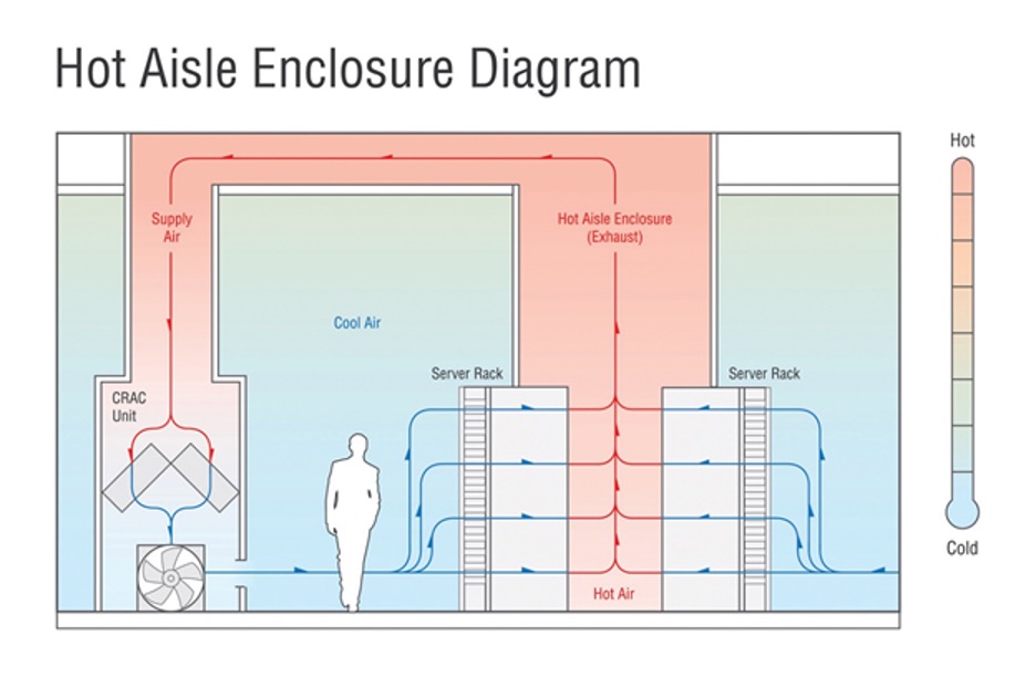

Hot-Aisle Containment
This method encloses the hot aisles within the data center. The heat discharged from the racks enters the hot aisle and is returned through ductworks or a plenum back to the cooling equipment. The cold air supply floods the rest of the data center through raised floor perforated tiles or overhead via ductwork.
Hot Aisle Enclosure Diagram
The primary advantage of hot-aisle containment is that the rest of the data center space remains cool. It also allows for low-density communications racks to be kept in non-contained areas. It also requires less management in terms of air distribution. So long as the cold air enters the main data center area and the hot air is properly returned to the cooling equipment, even if the cooling outlets are far from the servers it is still efficient.
There is an inherent disadvantage, however, and that is when technicians need to access the equipment at the rear of the rack, this is all contained in the hot aisle and it is a very uncomfortable place to work. You may need temporary cooling to be installed for hot aisles if frequent access to the rear of the racks is required.

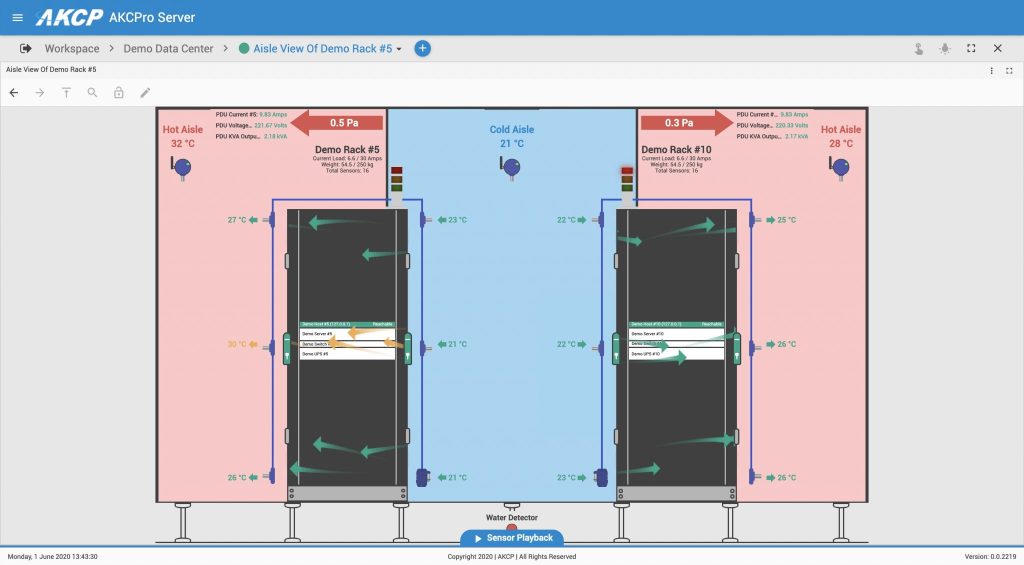

Monitoring Solutions
AKCP offers monitoring solutions for hot and cold aisle containment. With sectional views of your data center containment aisle to visualize the current status. Slice through your aisle at any rack location, view differential air pressure between the front and rear of the racks, thermal maps, ∆T values, hot and cold aisle containment values. This data can be used together with power meters to check your PUE numbers, and fine-tune your data center for maximum efficiency.
APS Containment View
