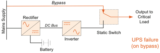

Before knowing UPS failures, you need to understand UPS systems first. UPS stands for uninterruptible power supply. As mentioned, it is a device that provides a backup supply of electricity. It also regulates the electricity that powers critical IT equipment.
UPS systems have energy storage batteries. It connects short-term power loss between utility power failure and backup generator systems. UPS systems typically function for up to 10 minutes or more. Just long enough toast until the generator takes over.
  • Components of UPS Systems
Photo Credit: www.kohler-ups.co.uk
  • Rectifier
It receives AC power from an input source. The AC power is then converted to DC power to provide energy to the inverter. As well as charge the battery bank or energy storage.
  • Battery bank or Energy Storage
All UPS have some kind of system to store electricity. This electricity can be stored in the form of batteries, flywheels, or supercapacitors. This makes UPS supply uninterrupted power. In online UPS, nickel-cadmium or free lead-acid batteries are typically used.
  • Static Bypass
Also known as automatic bypass. In case of UPS failure, the input power source delivers static bypass without break.
  • Manual Bypass
Also known as maintenance bypass. This is utilized when UPS systems need maintenance.
  • Inverter
It converts DC power from the rectifier into AC power required by the load. It delivers the required voltage and frequency in the outputs of UPS.

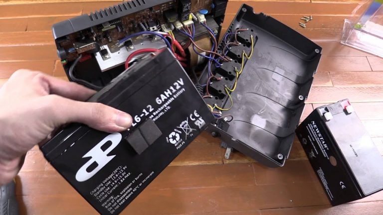

UPS failure is a leading cause of unplanned power outages in data centers. It results in costly downtime service and disrupts the overall operation of data centers. Batteries are the major culprit of UPS failure. Every UPS system has a set of batteries. One battery failure can lead to the failure of the entire set. Essentially, without the batteries, the UPS system cannot function.
Fans also play a major role in UPS failure. Most UPS systems have several fans. If these fans do not function properly, the system will overheat and shut down. Typically, fans can last for seven to 10 years. It depends on how frequently they are used. It can also vary with the temperature that fans work with. Note that the temperature they work with should be around 22°C to 25°C (72°F to 77°F).
Capacitors are also essential to the operation of UPS. They filter out the voltage spikes. If capacitors fail, the UPS system will not function. Typically, these components also last for seven to 10 years. Just like the fans, they also depend on the temperature they work with. If the temperature is higher, the capacitors will likely shrink immediately.

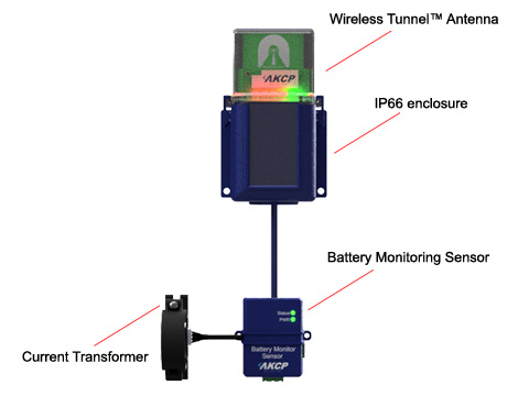

Wireless Battery and Solar Panel Sensor
Wireless Battery and Solar Monitoring
Wireless Tunnel™ radio module with battery monitoring sensor can check battery health and solar panel output. And check solar panel efficiency. Monitoring current draw of batteries to ensure charging current is sufficient. The sensor monitors Voltage, Current, and Temperature. Works with all Wireless Tunnel™ Gateway.
Sensor Details
  • 4x AA Batteries
  • External 5VDC or 12VDC power
  • LED indicators for power, status, and RSSI
  • Optional DIN rail or pipe mounting
Typical applications would be for monitoring a battery bank, solar panel array, or generator starter batteries. Visit akcp.com for more details.
