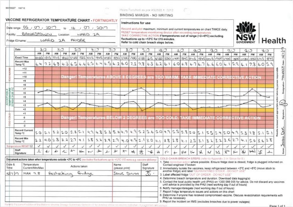

Staff should check and record the minimum and maximum storage unit temperatures at the beginning of each workday. If the TMD being used does not display the minimum and maximum temperatures, then the current temperature should be checked at the start and end of the workday.
A log sheet should be placed at the storage unit door to monitor the temperature. The following details should be taken note of:
  • Date
  • Time
  • Name of personnel who recorded the temperature
  • Actions that were taken in the event of a temperature excursion
  • Minimum/maximum temperature (or current temperature if using a TMD device that does not show the minimum and maximum temperatures)
Manual temperature monitoring chart for vaccines
Unit doors should always be tightly closed. It is best to review storage unit temperature readings per week regarding the changes in the temperature trends that might require immediate action like replacing equipment or needed adjustments regarding the unit temperature. Temperature data should be stored for three years to better study reoccurring temperature patterns.
