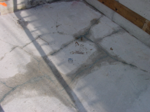

Analyzing the concrete mixture is the key to a strong structure. Concrete that has inappropriate temperature and setting may have a hard time solidifying. This will sacrifice not only the quality of the structure but also the safety of the people.
Photo Credit: forconstructionpros.com
Monitoring the concrete temperature will provide useful data about the curing process. Performing this critical step will eradicate complications. Examples are overheating of the concrete, which usually happens on mass concrete. It can also help avoid a large temperature gradient. This can result in possible cracks on the structure after completing it. The temperature gradient is the difference between the inner core and surface of the concrete. Chlorides and other liquids can enter these cracks damaging the reinforcing steel.

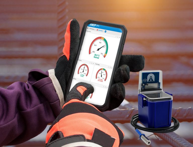

AKCP Wireless Temperature Sensor
Increasing longevity and minimizing damages are the goals of every mass placement project. Temperature plays a critical role in achieving these two. Temperature monitoring is important to systematically track the process of curing concrete and ensure a finished structure’s quality. Isn’t it good to think that the structure will still stand strong for the years to come?
A more convenient data accuracy should not be a challenge. AKCP wireless sensors help contractors in monitoring the concrete temperature. Conveniently acquiring data on or off-site without compromising accuracy.
AKCP Wireless Sensor works with a built-in calibration check in a single stainless steel tube. Working as a pair, they check each other’s values once a second for accuracy. If the sensors detect temperature are out of allowable thresholds, an alert is sent warning that the sensor requires re-calibration.
  • 4x AA Battery powered, with 10 -year life.
  • USB 5VDC external power.
  • 12VDC external power.
  • Custom sensor cable length up to 15ft to position sensor in an optimal location.
  • NIST2 dual-sensor calibration integrity check.
  • NIST3 triple sensor calibration integrity checks with failover.
