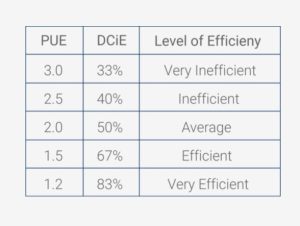

Industry benchmarking of data centers using PUE and DCiE will create a comparison to evaluate the current data center design. It will allow administrators to strategize how to improve efficiency. To come up with a valuable benchmark, it should be done regularly on different days and times.

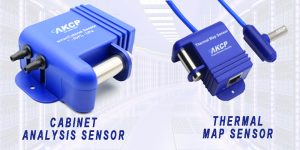

Cabinet Analysis and Thermal Map Sensors

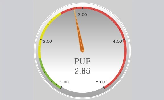

AKCPro Server shows live PUE calculations. Using power meters the total facility and IT loads are used as the input. The resulting PUE is displayed dynamically. As your facility loads change, the live PUE numbers will also update. Make changes in your facility and see instantly how much power you are saving. With the addition of cabinet thermal maps, you can ensure maximum PUE, while not violating ASHRAE recommended inlet air temperatures. Cabinet thermal maps also monitor the △T across the rack to ensure cooling is being utilized.
AKCP monitoring solutions allow you to gain detailed insights into your data center facility’s environmental and power parameters. Checking for hotspots, differential air pressure, and airflow around your data center. Ensure that real-life measurements match predicted cooling and airflow analysis from CFD models. Once you have the proper sensors and monitoring in place, the measurements can be used to begin controlling your data center for maximum efficiency. The first thing to do is determine what is your current PUE and use this as a benchmark.
