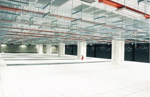

The data center building requires no ducting or cooling pipelines for the data hall as a result of the thermal design mentioned in the preceding section, obviating the necessity for access floors. As a result, we were able to use concrete slab-on-grade to tile the data center flooring. This option saves money while also providing a larger bearing capacity and allowing for greater construction height. We were able to avoid static dissipation flooring because we can manage the humidity in the building and maintain it high enough.
Instead of standard corrugated metal, the ceiling employs lightweight composite deck concrete, which increases the diaphragm load and protects the environment. With strategically placed diagonal bracing, the stronger ceiling allowed structural adjustments that resulted in greater open space. For lower power usage and cabling, the lighting system use power-over-ethernet. Each fixture also has diagnostics, such as temperature for efficient cooling, as well as brightness, bulb life, and occupancy sensors for automated output adjustment.
The weight-bearing columns in the building are oriented behind the battery cabinets, decreasing resistance to airflow behind the servers that create the heat because we employ custom-sized racks with battery cabinets in between at defined intervals. For improved airflow and to give it its own, more lenient environmental criteria, we detached the office space as an attachment to the computing area.
