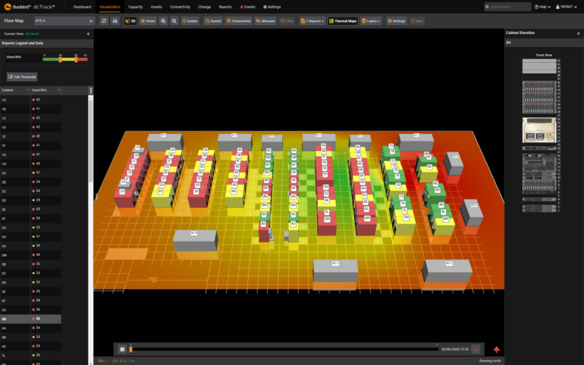

Case Study
A top healthcare provider in the USA recently implemented thermal map sensors from AKCP on every rack in their data center. The sensors are monitored through Sunbird DCIM via SNMP. Sunbird provides data analytics, alarming and visualization tools to show hot and cold spots in the data center. This has allowed the data center to get an insight as to where they are wasting energy through overcooling, release stranded capacity by increasing server loads and safely manage hotspots when operating the data center at elevated temperatures.
Sunbird DCIM data center temperature optimization
Thermal map sensors consist of 3x temperature sensors at the front, and 3 at the rear of every rack, giving you measurements of rack inlet, outlet and ∆T. DCIM software from Sunbird uses this sensor data to create heatmaps of the data center.
The healthcare provider discovered that they were overcooling servers throughout their data center, and could safely increase their data center operating temperature without creating hot spots. They successfully reduced their energy use by 18% while maintaining safe operating conditions for their servers. Based on the results achieved, they are preparing to roll out the same setup at their second data center facility.
