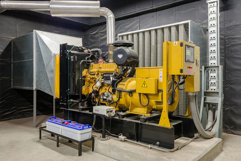

Locating your EPSS
As your EPSS must provide reliable backup power, they should be protected to ensure continued function during natural disasters or fires.
If the EPSS is located inside your main building, they need to be located inside a room that has a minimum fire-resistance rating (FRR) of 2 hours. No other equipment should be installed in this room other than that associated with the EPSS.
Externally located EPSS must be shielded from rains, wind and snow. Shelters for the EPSS should be designed in compliance with local building codes with suitable level of wind and rain resistance. If you are located in areas prone to storms, tornadoes or earthquakes, these should be considered in the shelter design.
The goal whether located inside your facilities or outside, is to protect the EPSS to ensure continued operation when called upon.
NFPA 110 Power Switching Time
NFPA 110 specifies different categories of EPSS. Hospitals fall into the class 10 category. This means that the system should be able to start and restore power within 10 seconds of the main line power failure. In technical terms, it is the maximum time for which the terminals on the transfer switch can go without electrical power.

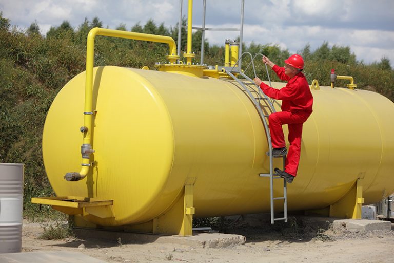

NFPA 110 Fuel Storage Requirements
The regulation also outlines the recommended amount of fuel that should be stored on-site for facilities engaged in critical life support systems. The amount of fuel required will depend on the duration (number of hours) runtime you need at maximum load capacity without refueling.
Your locations seismic category will also have a bearing on the fuel storage capacity. A low seismic risk (A) to very high risk (F)
Hospital Emergency Power Supply Systems fall in Class X should have a minimum of 4 days (96 hours) fuel stored on site based on the running at maximum kW rating of the generator. In the event of a natural disaster the delivery of fuel replenishment can not be guaranteed and so the ability run at full capacity for several days is vital.
In addition, there is a requirement for the fuel tank to be sized at 133% of the fuel needed. THis means for a large generator you may require 18,000 gallons of fuel for 96 hours operation. +33% results in 24,000 gallons of fuel stored on site. For rural locations where fuel delivery logistics can be difficult, 150% or more oversizing of the tank may be applicable.
As already said, the NFPA 110 does not give a list of requirements that meet your local regulations. However, a good understanding the recommended best practices in NFPA 110 will aid in navigating compliance with  your own local regulatory authority requirements.
Diesel should not be stored for more than 12-16 months.

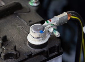

NFPA 110 Battery Capacity Requirements
The starting system of the generator typically relies on a battery for cranking and startup. NFPA 110 recommends for an EPSS at hospitals the battery should be capable of 3 cycles of canking for a period of 75 seconds each. The battery should be connected to a recharging system that restores full battery capacity within 24 hours. A low battery voltage alarm system should also be installed. An automatic battery charger that keeps the battery trickle charged during standby is required. Monitoring battery charging currents and voltages can be achieved remotely with the installation of sensors.

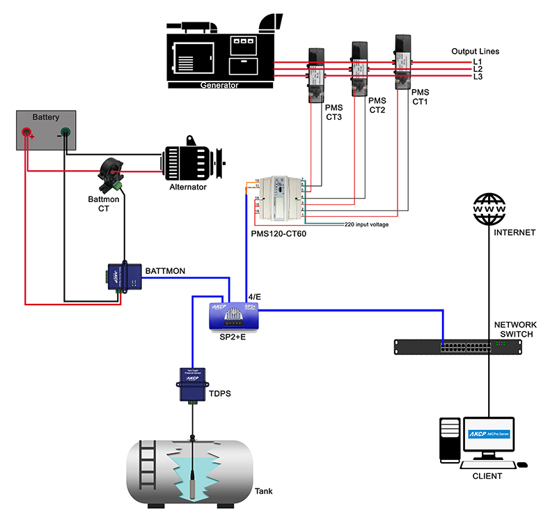

AKCP Generator Maintenance Monitoring Solution
AKCP provides a complete range of tools for generator maintenance monitoring.
SP2+E
3 sensor port device, with Modbus RS485. Connect to your generators Modus panel, with the option to add sensors such as fuel level sensordry contact inputsbattery monitoring sensor. Ethernet communication comes as standard. Optional cellular modem provides remote communication and alerting through the 4G network.
Tank Depth Pressure Sensor
Suitable for tanks up to 20 meters in depth. Tank depth pressure sensors will measure the pressure exerted by the column of fuel above. By entering the tank dimensions the volume is calculated. Fuel tank volume can be displayed and graphed.
Battery Monitoring Sensor
Monitoring of battery terminal temperature, current and voltage. Ensure your battery is healthy and has sufficient voltage to start the generator when needed.
Dry Contact Sensors
Take in alarms from generator control panels.
Power Meters
1ph and 3ph power meters with current transformers. Check generator power output, frequency and voltage.
