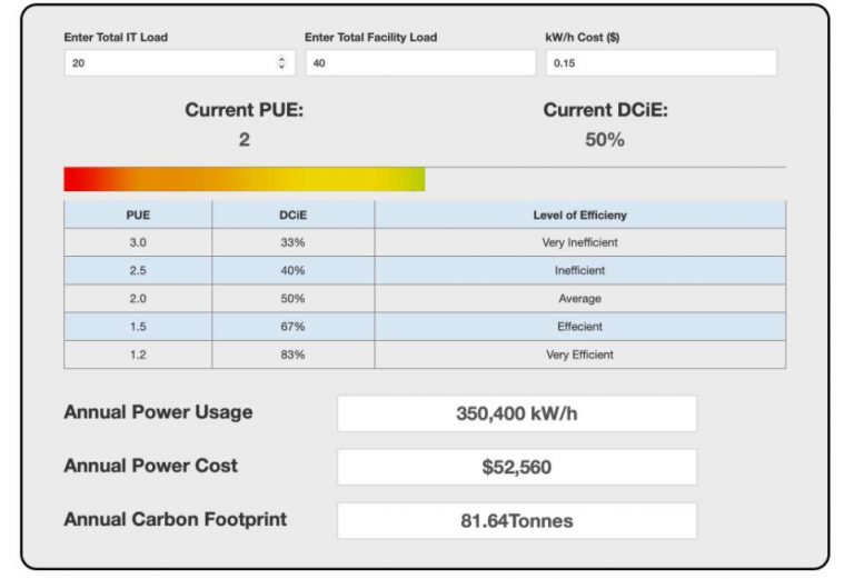

AKCPro Server shows live PUE calculations. Using power meters the total facility and IT loads are used as the input. The resulting PUE is displayed dynamically. As your facility loads change, the live PUE numbers will also update. Make changes in your facility and see instantly how much power you are saving. With the addition of cabinet thermal maps, you can ensure maximum PUE, while not violating ASHRAE recommended inlet air temperatures. Cabinet thermal maps also monitor the △T across the rack to ensure cooling is being utilized.
By monitoring PUE over a period of time, AKCPro Server creates a graph of your PUE. This allows data center managers to evaluate how changes have impacted PUE and measure improvements. By combining PUE metrics with other sensor data you can ensure maximum data center efficiency. Yes, you may have a great PUE of 1.25 but half your servers are sitting idle. What happens when they spool up? What about cooling capacity, is it being fully utilized? Are you running your data center too cold?

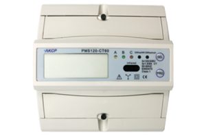

Power Monitoring Sensor
Try out our online PUE Calculation Tool here
