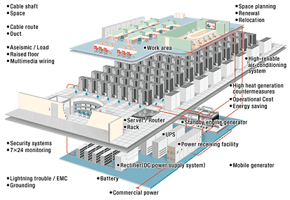

Optimize Data Center Design
If your data center has a raised floor, place the hottest racks in front of the perforated tiles. You may also change to other perforated tiles to match the airflow to the heat load. Do not place CRAC/CRAH units close to the perforated tiles. This will lead to a “short circuit” of air. The cool air will flow back immediately into CRAC/CRAH units. Hence, taking sufficient supply of cool air to the facility.

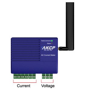

Power Monitoring
Wireless Current Meter
AKCP offers a wide range of solutions for all your data center needs. With over 30 years of experience in professional sensor solutions. AKCP created the market for networked temperature, environmental, and power monitoring in data centers. AKCP is the world’s oldest and largest manufacturer of network wired and wireless sensor solutions. For more details, visit AKCP at akcp.com.
Monitor single-phase, three-phase, generators, and UPS battery backup power. AKCP Pro Server performs live (PUE) calculations. So you have a complete overview of your power train. As well as how adjustments in your data center directly impact your PUE.
