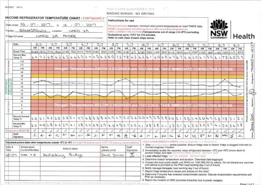

The Australian Government department of health published a chart that should be filled in twice a day. Manual temperature checks and plotting on the chart is a time-consuming and error-prone task. When the temperature is out of range, it is unknown for how long the condition has existed since the last check.
Image courtesy of NSW government

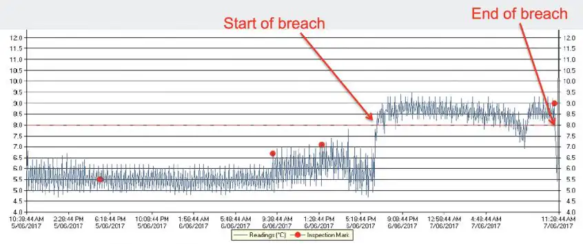

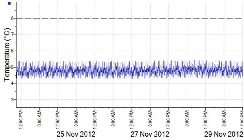

The below charts are an example of data collected from a monitoring system.
The first chart is from a stable refrigerated storage environment. The temperature fluctuates with the compressor cycles but is maintained within the defined limits.
The second chart illustrates a high-temperature breach. This could be caused by a power failure or malfunction of the refrigeration system. A temperature monitoring system would alert once the threshold has been exceeded allowing for immediate response. A power monitoring system on the refrigerator would give an earlier warning of the problem.
Charts courtesy of NSW government
