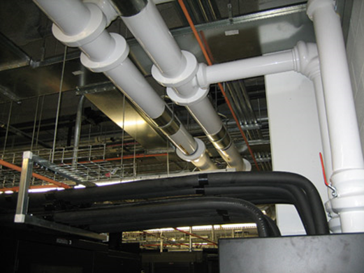

Image source researchgate.net, Data Center Cooling Topology
