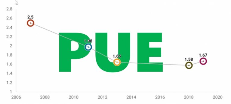

The initial PUE measurement determined a data center’s energy efficiency through a one-time measurement of power in kilowatts. However, it tends to be misleading because some facilities can claim low PUEs during a cold spell when the need for cooling energy is minimized.
It was updated to PUE version 2, which took into account annualized energy instead of power. It categorized PUE into four, PUE 0-3, and three specific measurement points. If the data center does not have the needed energy meters at the specified measurement points, they use PUE, which measures power based on the highest draw during warm weather to provide a more accurate representation. The other three PUE categories are based on annualized energy (kWh).
