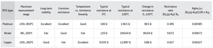

The two standards for PT100 RTDs are the European or IEC standard, and the American one. The former serves as the worldwide benchmark for platinum RTDs. It must have an electrical resistance of 100.00 O at 0℃. A temperature coefficient of resistance (TCR) of 0.00385 O/O/℃ between 0 and 100℃ is also required.
If you’re using a PT100, you can compute the precise resistance to a temperature conversion.
