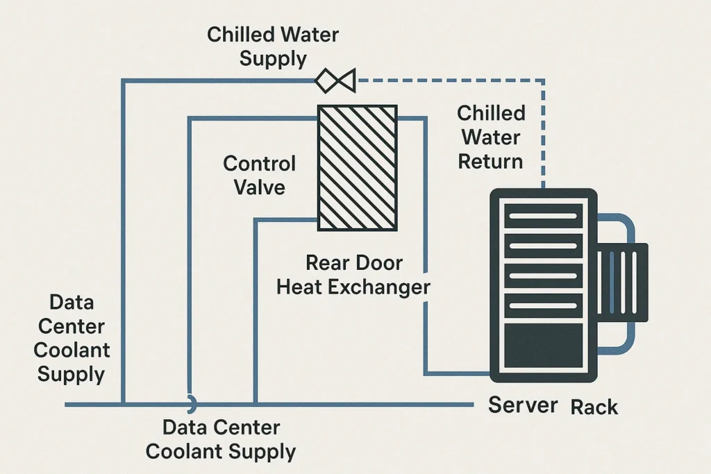

Understanding RDHx: Cooling at the Source
A Rear Door Heat Exchanger is a passive or active liquid-cooled panel mounted to the rear of a server rack. As hot exhaust air exits the servers, it is immediately passed through the RDHx. Here heat is transferred to a circulating liquid, typically chilled water or a refrigerant. This process drastically reduces the temperature of the exhaust air before it re-enters the data hall. This allows for significantly better containment and environmental control.
By absorbing thermal energy at the rack level, RDHx systems eliminate the need to cool the entire room volume. This is a fundamental inefficiency of traditional air-based systems. Moreover, they can often function without fans (passive RDHx) or with minimal airflow assistance (active RDHx), resulting in further energy savings.

Engineering Considerations and Coolant Infrastructure
The effectiveness of RDHx systems depends on several engineering factors:
Coolant Type and Temperature: While traditional chilled water systems operate at 7–15°C, some modern RDHx units can function with warm water (up to 40°C), enabling free cooling for much of the year. Systems like the IBM CoolBlue RDHx pioneered this concept, significantly reducing the mechanical cooling load.
Flow Rates and Thermal Transfer Surface: High-density racks may require water flow rates in excess of 15 GPM per rack. Heat exchanger design—including fin density and surface area—affects the heat transfer coefficient, which must be optimized for peak loads.
Piping and Connectivity: RDHx deployment involves integrating a closed-loop cooling circuit, either directly from a central chiller or via in-row CDU (Coolant Distribution Units). In facilities where flexibility is key, quick-disconnect fittings and overhead routing are recommended to minimize disruption during maintenance or reconfiguration.
