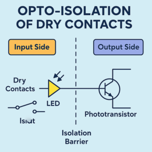

How Isolation Technology Works in Dry Contacts
Isolation technology in dry contact modules work by electrically separating the input (monitored side) from the output (monitoring device side), preventing direct current flow between them. This is crucial for avoiding ground loops, voltage spikes, or interference that could damage equipment or cause false readings.
The most common method is optical isolation (opto-isolation), which uses an optocoupler, a component consisting of an LED and a phototransistor sealed in a light-proof package. The process works as follows
- Signal Detection: When the dry contact closes (or opens), it triggers a small current to light up the LED on the input side.
- Optical Transmission: The light from the LED activates the phototransistor on the output side, which then switches the circuit without any physical electrical connection.
- Isolation Barrier: This optical link provides isolation, ensuring that high-voltage transients on one side don’t affect the other.
Other isolation methods include magnetic (transformers) or capacitive coupling, but opto-isolation is prevalent in dry contacts due to its reliability and low cost. In AKCP modules like D1i or D1iV, this technology enhances safety by isolating the inputs, making them suitable for harsh environments where electrical noise is common. Overall, isolation not only protects your AKCP device but also extends the lifespan of connected systems by minimizing wear from electrical stress.
