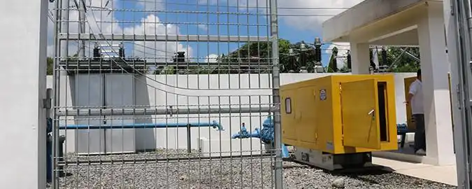

The deep well pumping station is critical to Clark Waters operations, with the generator running 24 hours per day with a backup secondary genset for emergency use. At this site, the generator did not have a control panel with RS485 Modbus connectivity. AKCP was able to satisfy the monitoring needs by installing our own sensors. An SPX+ with DIN rail mounting was deployed at this site. The SPX+ was equipped with 4 sensor ports and 10 optoisolated dry contacts and cellular data modem for sending SMS in critical situations. A dual temperature and humidity sensor were placed inside the electrical panel.
An ultrasonic fuel level sensor provides alerts when the fuel level is critical and requires refiling. Dry contact inputs were utilized to monitor the generator on/off status, as well as provide alerts if the generator doors or control panels are accessed. A DC Voltage sensor was connected to the battery so it’s health can be remotely monitored.

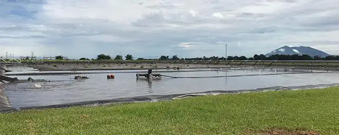

Located at the Northern end of Clark, is the main wastewater treatment area. Critical to maintaining a healthy environment it is essential this site is operational 24/7/365.

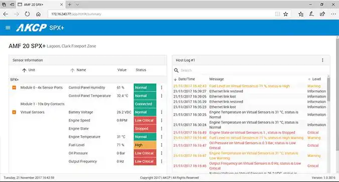

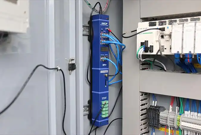

A larger site than the pumping stations, this was equipped with a larger Cummins genset with ComAp IntelliLite AMF20 control panel. An RS485 Modbus connection was made from the SPX+ to the control panel, enabling AKCP to monitor the engine parameters remotely. Oil pressure, battery voltage, engine temperature, fuel level, engine speed, runtime and engine status, were programmed using the relevant Modbus registers in the SPX+. This allows Clark Water to closely monitor the generator’s status, as well as scheduled preventative maintenance when a specific number of hours runtime is reached for example.
Due to the distance from the main control panel room and the generator, which was located in an outbuilding, the SPX+ was connected via a WiFi network connection, and then to the wired network infrastructure already in place. The cellular data modem provides an extra layer of communications, by sending SMS alerts in critical situations.

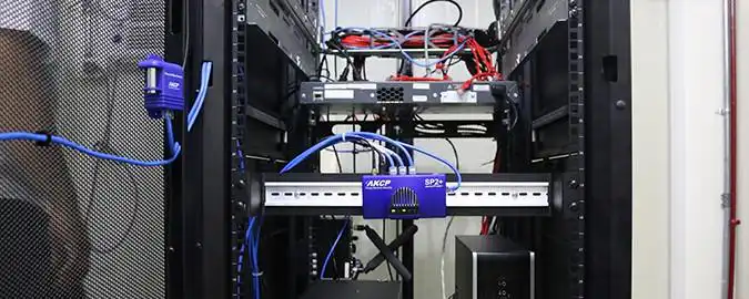

Genmon installed environmental monitoring devices in the mini data center, using the SP2+ DIN rail mounted in the cabinet with thermal map sensors to monitor the temperature at the top, middle, and bottom of the cabinet. Monitoring of temperature means should the air conditioning fail advance notice is given and corrective action can be taken to prevent overheating of sensitive IT equipment.
RFID Swing Handle Cabinet Locks were added for securing access to the front and rear doors of the cabinet. Centrally managed through AKCPro Server it allowed Clark Water IT staff to control access to the cabinet and provides an audited log of access events.
