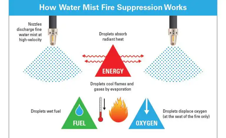

Water Mist Fire Suppression
Water is the most used suppression agent in all buildings since water sprinklers are usually part of local city fire codes. Sprinkler systems are designed to save structures and save lives. That kind of fire suppression system, however, can be where the cure is worse than the disease. There is an alternative water-based fire suppression system which can minimize the amount of water needed to suppress the fire, and that has been specifically designed for Data Center fire suppression.
Water mist consists of finely atomized water droplets. A high-pressure water mist system produces water droplets, 99% of which measure less than 100 microns in size. These tiny droplets provide a larger surface area for heat transfer. This causes more of the water mist to be vaporized into steam, giving off radiant heat, increasing the cooling effect, to extinguish the fire.
Since water is vaporized during the suppression process, the water mist does not reach the systems’ critical assets, thus minimizing the damage. These systems do not require large amounts of water, as opposed to conventional sprinklers. This is practical especially in locations with limited water supplies, or where municipal water pressure is low. Since the old sprinkler systems rely on using the same water supply as fire hydrant lines (water that can contain sediment and other impurities), water mist systems use potable water which is free of contaminants.

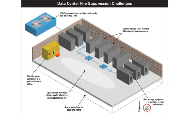

Data Centers are not all the same sizes and configurations, which is important in determining the proper design of a fire suppression system. Areas requiring a fire suppression system can range from specific equipment or assets, a single floor, a room, or an entire building.
Total Flooding Suppression
Data Centers with special computer rooms are protected by a “total-flooding” clean agent systems. When a fire occurs, the entire room is spontaneously flooded with the fire suppression agent. The quantity of fire suppression agent required is based on the overall volume of the protected room. The inert gas must be blended homogeneously throughout that space to achieve an effective concentration.
To completely contain the fire, the room or enclosure must be airtight. All the walls, floors, return air ducts, and ceiling slabs, including doorways and other possible openings, must be completely sealed off. If the room has air ducts, it will make the suppression system ineffective. There must be a means to close them.
