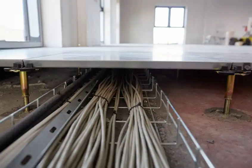

Airflow And Cooling Management
Overhead air ducts for cold air distribution tend to be limited. The delivery of chilled air under a raised floor is easier because arranging the perforated floor tiles is all that is required to change the air distribution. Raised floors also offer more room for cabling which eliminates the additional manpower and infrastructure that overhead requires.
Regardless of the many advantages of raised floors,  still accounts for many data center cooling problems. Uneven air pressure and spotty air delivery are commonly caused by air turbulence. Some buildings also do not have the slab-to-slab clearance for the height requirements of raised floor type data center.
The space under the raised floor is used for cabling which becomes an obstruction for air cooling. Therefore, proving a raised floor design is not fit to accommodate higher-density rack deployment (8kW–10kW per rack and up).
Moreover, a data center that uses the raised National Electrical Code floor space is required to have an emergency power-off button next to exit doors as stated in Article 645 of the National Electrical Code.
Each panel must be a perfect fit and tight to avoid air leakage and every edge next to the walls and air conditioner must be tightly sealed.
A 25% open perforated panel with no damper will pass 746 cfm of air at 0.1 inches of static pressure under the floor. Simply adding a damper and leaving it fully open reduces this to 515 cfm. That’s the equivalent of only 17.4% open. With a 56% open grate tile, the difference is even more dramatic – 2,096 cfm with no damper and only 1,128 cfm with a fully open damper.

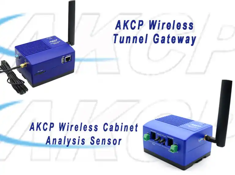

AKCP Wireless Sensor and Gateway
Wireless Cabinet Sensor
The W-CAS has a cabinet thermal map for detecting hot spots, a differential pressure sensor for airflow measurement, and two dry contact inputs for door security sensors. Data is captured and delivered to one of our wireless sensor gateways.
Thermal Maps
Cabinet thermal maps consist of 2 strings of 3x Temp and 1x Hum sensor. Monitor the temperature at the front and rear of the cabinet, top, middle, and bottom. The △T value, front to rear temperature differential is calculated and displayed with animated arrows in AKCPro Server cabinet rack map views.
Differential Pressure
To prevent air from mingling from the hot and cold aisles, there should always be positive pressure at the entrance of the cabinet. Because air goes from high to low-pressure zones, it’s critical to ensure that the front of the cabinet has higher pressure and the back has lower pressure for efficient cooling.
Door Contacts
I/O dry contact inputs can be used to monitor the front and rear doors of the cabinet, or alternatively alarm outputs from a UPS or other rack-mounted equipment.
