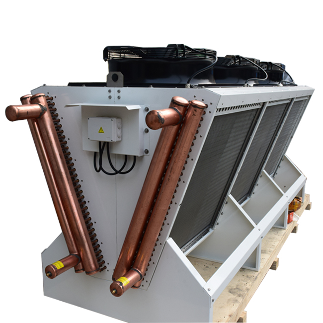

Dry coolers, adiabatic coolers, and cooling towers are all heat exchangers that transfer process heat from a liquid medium to the surrounding air. Nonetheless, there are variances in the technology and, as a result, various benefits.
Dry coolers transfer energy by heating the surrounding air, necessitating a large volume of airflow. To dissipate the energy, cooling towers evaporate water, resulting in high water consumption but low air volume requirements.

Throughout the year, the dry cooler is excellent for applications where the ambient temperature is lower than the desired return temperature. It’s also good for places with high humidity or where there’s no water.

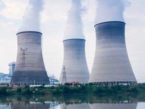

The waste heat from server rooms can be ejected into the atmosphere via cooling towers. They come in cross-flow and counter-flow configurations and can provide cost-effective free cooling. Cooling towers can be installed completely completed, whether modular or field erected, saving downtime on replacement projects and congestion on new construction sites.

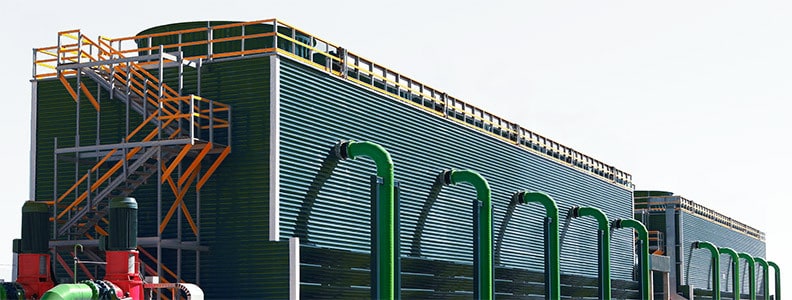

Function Cooling Tower
  • Water flows downward, while a fan draws air upward.
  • Counterflow cooling towers can successfully reach the wet-bulb temperature.
  • The evaporation of around 1% of the circulating water provides cooling.
  • Over the surface of plastic fills, direct contact between water and ambient air is produced.
  • Warm water flowing down via a cooling unit is cooled by air pulled above by a fan.
  • The temperature drops quickly due to evaporation and direct heat exchange.
  • Induced draught crossflow cooling towers are much quieter and smaller than counterflow cooling towers.
