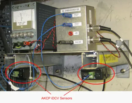

The system involves a beamline of Muons. The Muons can be either positively or negatively charged. The charge type is manually configurable, by physically swapping the input leads. This could be prone to human error, and so a system was needed to monitor the correct polarity. A Hall Effect Sensor from Honeywell was deployed to check the polarity. The Honeywell sensor is interfaced to an AKCP securityProbe 5E and iDCV00 digital voltmeter.
