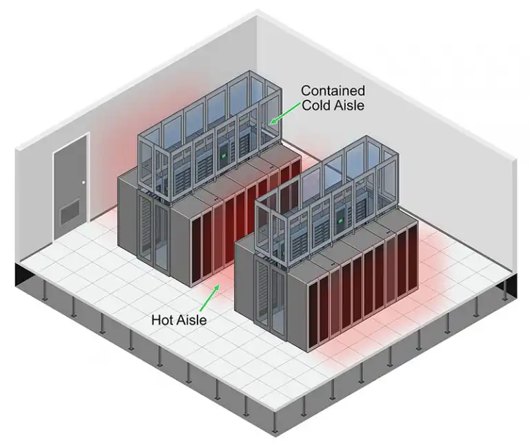

Lower energy costs in the data center have resulted in various strategies being employed. Many have implemented the separation of hot and cold air. This is known as aisle containment. The installation of blanking panels in empty U’s of IT cabinets and brushes for cabling to enter through has become common. In addition, the control of CRAC unit fan speeds can further reduce energy costs.

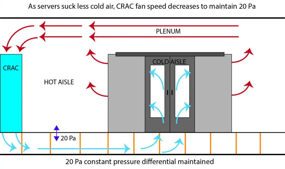

When the pressure differential sensor method is employed, a typical pressure difference of 20 Pa is maintained between the cold and the hot aisle. The cold air is
sucked through the servers by their fans. In addition, the air is forced through by the overpressure in the cold aisle. The speed of the fans in the CRAC or precision cooling unit is controlled to maintain the 20 Pa difference.

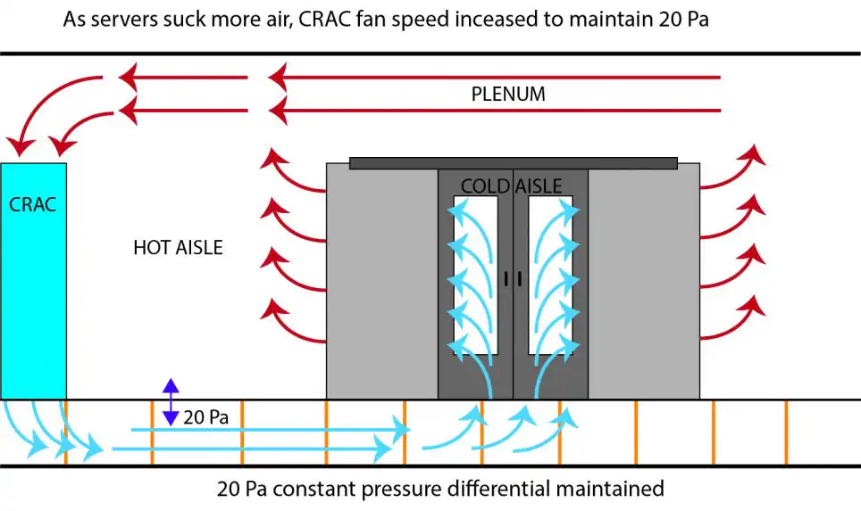

During high server loads, the cooling requirement increases, and the server fans will suck harder. In this case, the pressure will drop in the cold aisle, and so the CRAC fans are spooled up in order to keep the air demand and maintain the 20 Pa pressure difference.
Conversely, when server loads are low, the air demand is lower. In this instance, if the CRAC units were operating at full capacity te 20 Pa pressure difference would be exceeded. In this instance, the CRAC fan speed can be decreased, again to maintain the 20 Pa pressure difference between the cold and hot aisle.

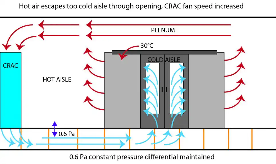

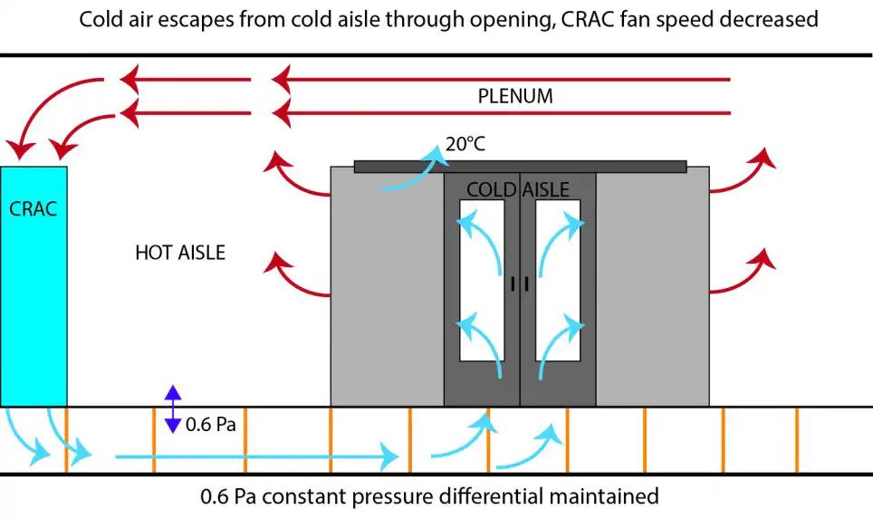

An alternative method of control is through a temperature sensor. In this method, the pressure difference between the cold and hot aisle is kept as close to 0 Pa as possible. A very slight positive pressure may be present to prevent backflow of hot air. However, with proper containment, the server fans themselves will generate sufficient pressure to prevent this occurring. In this method of control, the servers are sucking exactly the amount of air they need, and nothing more.
A temperature sensor placed at a small opening in the containment aisle measures the temperature of the air flowing through. As server loads increase, the server fans will suck more air. If the CRAC is not able to supply air fast enough, the air will be sucked out of the cold aisle quicker than it is replaced. This leads to a positive pressure differential between the hot and cold aisle. When this occurs, hot air will begin to flow back into the cold aisle through the controlled opening. The temperature sensor at this opening will measure this increase and signal the CRAC to increase its fan speed.
How then do you prevent overcooling in this system? The CRAC fans after being increased in speed will constantly decrease at a slow rate until again the temperature sensor detects an increase in temperature.

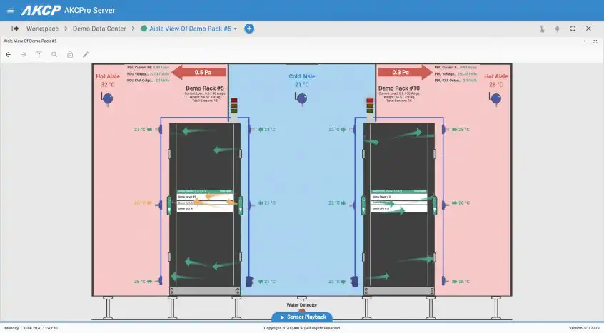

Hot and cold aisle temperatures, as well as pressure differentials, are visually represented in AKCPro Server DCIM software. This aisle view, accessible from the data center floorplan, provides a section through the aisle at the location you select. Showing the thermal map properties, front to rear temperature differentials (ΔT) with hot/cold aisle pressure differentials. The interface can also display other sensor data coming from your intelligent PDU, water sensors, rack security and RFID cabinet handle locks.
