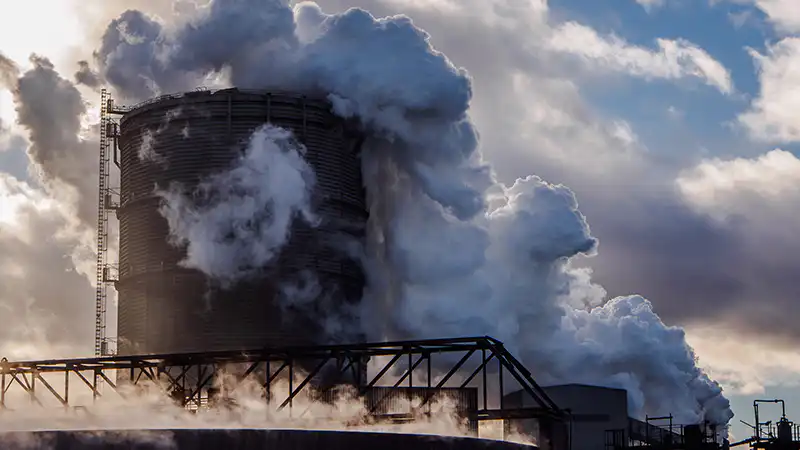

You Can’t Avoid It
A lot of data center sites sit in populated areas with high levels of pollution. Located in industrial parks where next-door establishments expel pollutants. These pollutants can cause contamination to the data center. In these cases, dealing with airborne contamination becomes an even more essential operation.
Operators of data centers do their best to make their businesses environmentally sound. They also try to lessen their carbon footprint. Likewise, they put effort into research and harnessing cutting-edge technologies. These technologies will further these visions into reality.
The advent of “free-cooling” has been fundamental to this undertaking. Although it is common knowledge that outside air cooling exasperates contamination issues. Outdoor air exists to regulate environmental atmospheres inside the data center. The same truth holds when indirect outside air systems co-exist. This is particularly true because of the Building Regulations and Codes. These codes mandate that a minimal amount of outside air must always be present. Even data centers in sites where there is no issue with air quality must draw up solid guidelines. This shows that they can maintain air cleanliness throughout their operating life. This stratagem is better for the needs of electronic equipment.

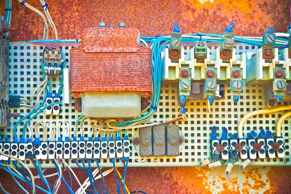

Humidity Causes Corrosion
Sites, where the atmosphere is hot, should always be watchful for shifts in the level of humidity. This is particularly true in cases where fluctuations cause temperature differences. Fluctuating levels of humidity heighten the risk of corrosion. This happens when components soak up moisture and they end up on electronic gear.
Manufacturers of equipment have known about this problem for almost a decade now. This has been true since the European Union put forth the ban on dangerous substances. This is called Restrictions on Hazardous Substances or RoHS. These guidelines for lead-free manufacturing became official policy in 2006. The implementation of these rules had unforeseen effects though. They brought about the use of non-lead alloys in solders. In contaminated atmospheres, these alloys are far more prone to corrosion.
Electronic and data communications equipment that follow RoHS regulations are at risk. This fact is especially true in places where ambient air is dirty. Data centers in downtown areas have more malfunctions due to sulfur corrosion.
For the past ten years, ASHRAE Technical Committee 9.9 (TC9.9) for Mission Critical Facilities, Technology Spaces, and Electronic Equipment has set clear parameters for contamination levels. This pertains to gaseous and particulate contamination in data centers. These parameters comprise part of the update of the ISA Standard 71.04-2013. (Environmental Conditions for Process Measurement and Control Systems: Airborne Contaminants).
One of the problems in complying with RoHS rules has to do with components. This pertains to those that use immersion silver (ImAg) surface finish. They tend to corrode in atmospheres classified as having a high sulfur content. These are environments that clock around ISA Class G2 or higher. Now, manufacturers have established very clear working guidelines and contaminant classifications. They do this to ensure that their products meet their printed warrantees.
