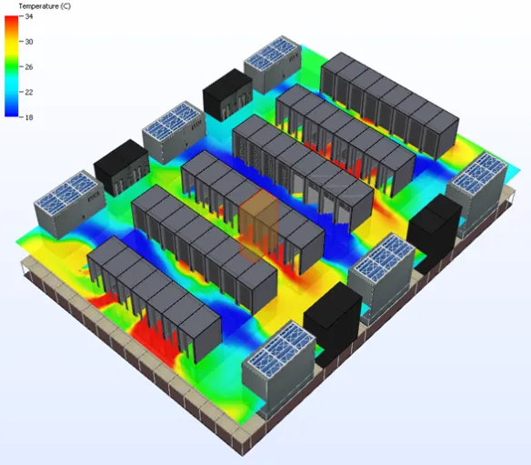

Identifying Potential Hot spots
Temperature is a critical part of data center management. It is the major cause of equipment failure. The study of Uptime Institute found that almost 10% of the racks run hotter than what is stated on the reliability guidelines. A hotspot is defined as “a location at the intake of IT equipment where the measured temperature is greater than the expected value as recommended by ASHRAE TC 9.9”. The ASHRAE thermal guidelines recommend an allowable temperature between 5 to 45°C (41 to 113°F). If prolonged, hotspots will affect the equipment’s performance and warranty agreement between the manufacturer.
The CFD can help managers in handling hotspots problems. The 3D simulation of the airflow movement provided by the CFD will show the areas receiving inadequate airflow. CFD allows virtual re-arrangement of the physical layout. Managers can virtually relocate the problem loads in the server room. This is done by moving the equipment from rack to rack to see how to get rid of the hotspot. Then, the high-power servers can be placed in the colder are with higher cooling capacity. Another solution adding open tiles on the hotter rack. The CFD will predict the airflow and temperature reduction through an interactive representation when these actions are taken.
