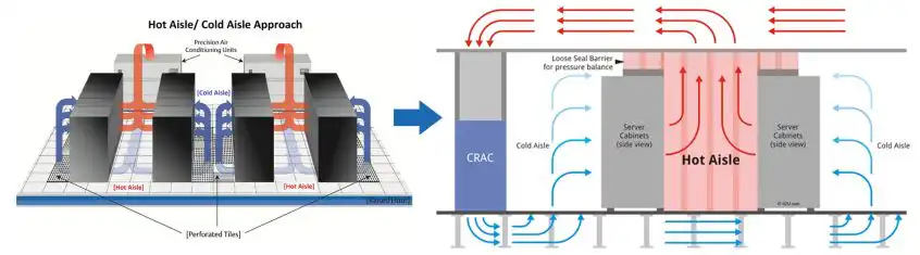

Data Center aisle containment separates the cold air supply from the cooling units and hot air exhausted by the servers. This approach ensures a consistent supply inlet temperature of the equipment and pure hot air return to the air-conditioning unit. The aisles/rows of server cabinets are arranged so that the front and rear of adjacent rows are facing each other.

Hot Aisle Containment
A hot aisle containment encloses the hot aisle making the rest of the room a large cold-air supply plenum. It gathers the hot air exhausted by the servers to return to the cooling units directly. An experiment like the cold aisle containment uses a door on the end of the racks. However, this approach requires the installation of ducts or baffles. These will restrain the air from flowing around the server room.
Since the rest of the room is cold, it will be more favorable for equipment. Individual equipment requiring lower temperatures outside the containment will not be affected. Furthermore, it is generally more effective. Data Center Science Center reveals that this approach can save 43% more cooling system energy compare to cold aisle containment. The drawbacks of this approach are the more works and costs to execute. The technician may also have a hard time checking the equipment at the containment due to the high temperature.
