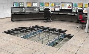

A significant function of a raised floor is to facilitate good data and power cabling. Early versions of IT equipment from past data centers come in different shapes and sizes. This variety made it challenging to plan equipment locations. The raised floor becomes a promising pathway for equipment data and power cables.
Space underneath is ideal for routing these cables in the most strategic location that would be easy access for users. It serves as a practical design structure to connect IT equipment and run it efficiently. When these power cables are in order, server operation is easy.
