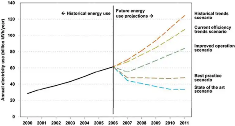

Since the mid-2000s, as computing technology became faster and more powerful, designers and operators were concerned about the efficiency of air-cooling technologies to cope with the increasing energy-draining servers. With power requirements approaching or exceeding 5 kilowatts (kW) per cabinet, some data centers have to resort to technologies such as rear-door heat exchanger and other kinds of in-row cooling to keep the servers cool.
In the Economic Meltdown of Moore’s Law Ken Brill of the Uptime Institute predicted in 2007 that the heat from fitting more and more transistors onto a chip would result in reaching a point where it would not be feasible to cool the data center without radically revising current cooling technology.
The concern was sufficiently significant for the U.S. Congress to begin investigating. Congress was aware of data centers and the amount of energy they required. It ordered the U.S. Environmental Protection Agency (EPA) to make a study and report on data center energy consumption (Public Law 109-341). This law also ordered the EPA to create efficiency strategies and drive the market for efficiency. This study predicted vastly increasing energy use by data centers unless measures were taken to significantly increase efficiency.
Moore’s Law hasn’t yet happened, but once it does, the result will be limitations in the design of chips and transistors to preventing overheating. This will affect the efficiency of the next generation of data centers.

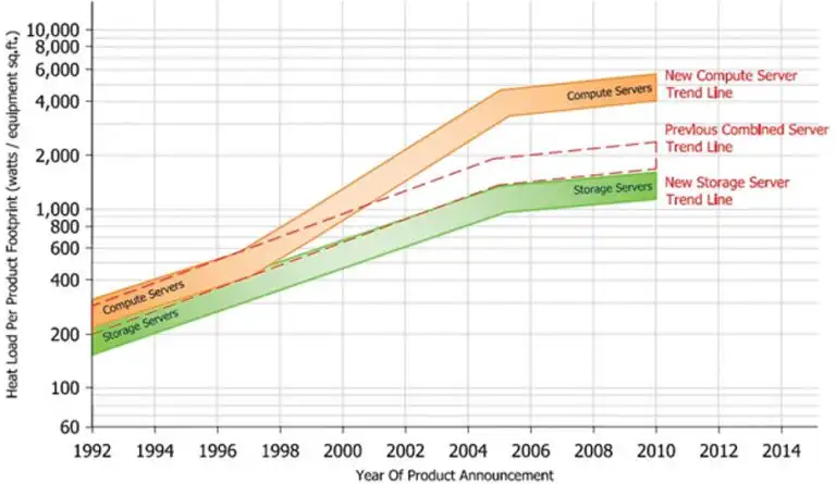

Heat load, often measured in kilowatts, should be the prime issue in designing the cooling system.
It includes two factors: The total heat to remove and its density. Data centers usually measure heat density in watts per square foot. Many speculate that density should actually be measured in kilowatts per cabinet, which is practical where one knows the number of cabinets to be deployed.
